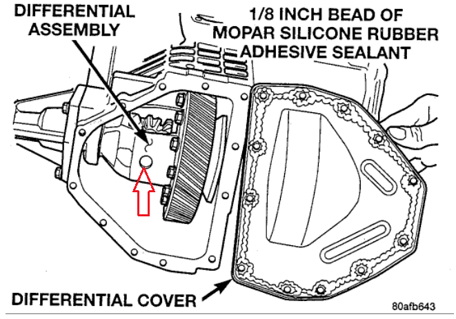

I was driving on interstate going straight and even speed when I heard a thud, van jerked (as if I ran over a small pothole) then car continued as if nothing happened. I drove about ten more miles then transmission started to shift funny, as if it had insufficient transmission fluid. Also I smelled what could be transmission fluid. I pulled over to open hood to see what was wrong, and saw a trail of transmission fluid behind the van. I didn’t see much under hood, but figured if I was leaving a trail, I’d better get back home, ASAP.
After I got home and up van up on stands, I saw a huge chunk of transmission case had blown out by the differential. After I had removed the transmission, what had happened was the bolt that holds the differential pinion shaft bolt had backed loose and out. What happened was the pin started to walk out and then hit the case, leaving a 6 inch by 6 inch hole. To be honest, and with pin walking around, I was lucky to get home.
One can’t fix a broken case, so I obtained a used transaxle, rebuilt and installed it, and all was good.
