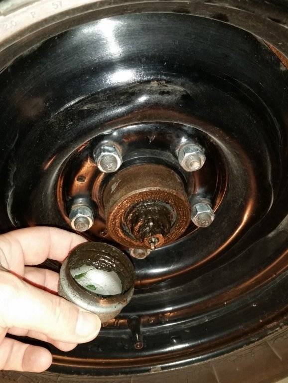

Lower car down, pop hubcap off and next thing I know is the dust cap falls off as well.
Note: dust cap was loose behind hub cap.
I just changed tires/wheels on car before a car show in June, in process I cleaned off excessive grease by the dust caps. Car had newish brake pads on car when I purchased it 4,000 miles earlier so I had nothing to do with that (yet). Brake pads still look almost new.

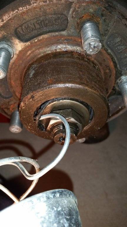

Remove wheel and check for play again. Not a pretty sight. I took a short video, but its 50MB in size.

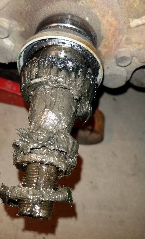

Cotter pin is still in place. The nut is a bit harder to remove than usual. I find something behind the nut and was able to capture it with drop light.

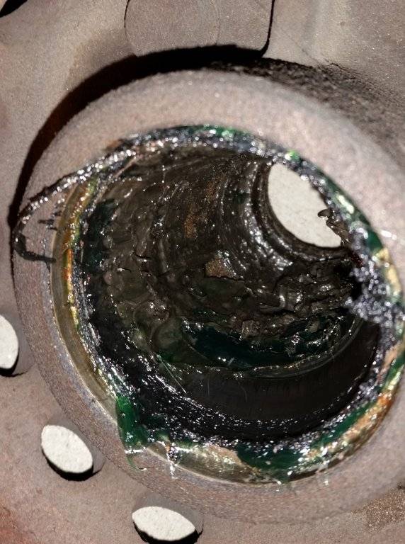

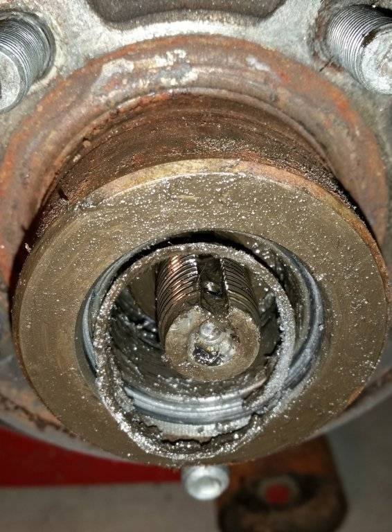

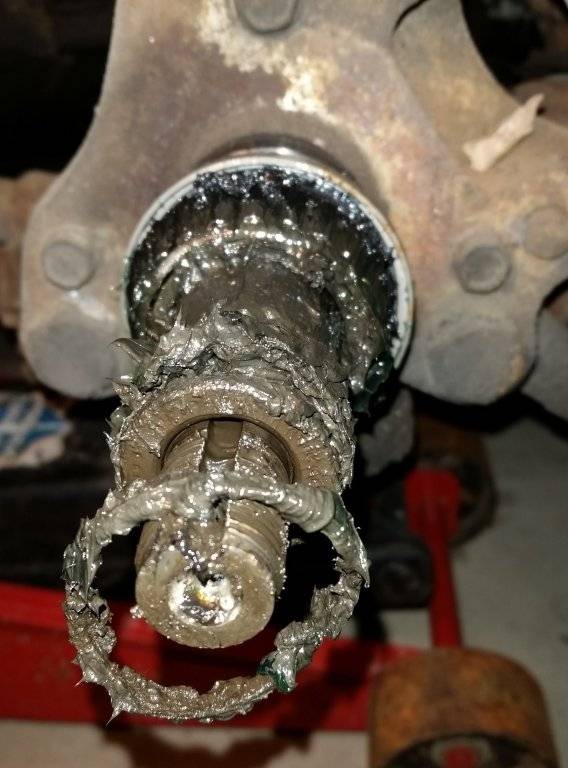

The inner bearing and inner bearing surface on spindle looks ok – but outer bearing is siezed onto spindle (not good). At this time, I figured its time to stop now before waking the sleeping kids.
You can see parts of the bearing (barely).

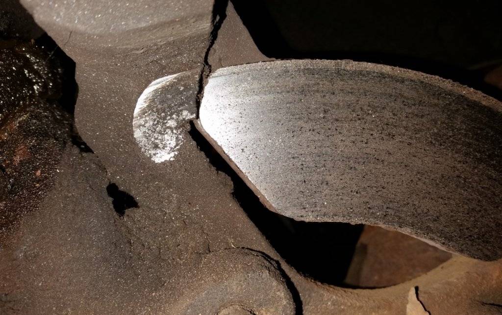

You can see where the brake rotor was making contact with brake caliper bracket.

I just got the inner wheel bearing removed from the spindle, using a puller. The spindle shows no sign of discoloration but does have some light scoring to the outer bearing surface.
Spindles are heat treated from factory and I believe if a spindle got hot enough to turn blue or black, then the heat treating might no longer be present (no facts to back this up). Spindles are too important for me to trust a discolored from heat, issue.
I think some light filing may take care of the roughness to inner bearing spindle surface. The inner bearing (the large one) is one that takes most of the vehicle weight and that bearing spindle area looks great – so I think I will be fine. Matter of fact, the inner bearing has some recent iron shavings in it but otherwise looks decent.

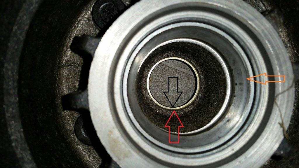

I spent a good amount of time trying to replace the outer bearing race from the brake rotor, this morning, and ruined a punch doing so. After looking at the brake rotor (which is fine except for this bearing race) – there is NO provision machined into the rotor to punch the old race out.
I ended up getting a new brake rotor ($50 bucks, US) so I could get car out of where my wife parks at, and wagon back on the road.
The outer bearing race, as viewed from back side of (new) brake rotor, is shown between the black and red arrows. There is a bit of a lip to use a punch to tap it out with (but not much). My existing rotor had a wire thin lip. I took photos but sense it wasn’t clean, pictures didn’t show up, well.
The inner bearing race is shown by the orange arrow.
