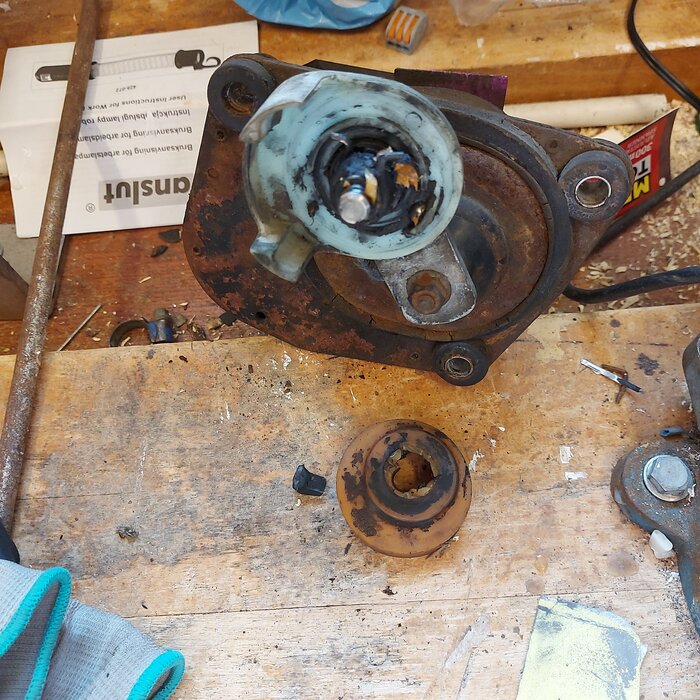

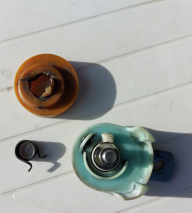

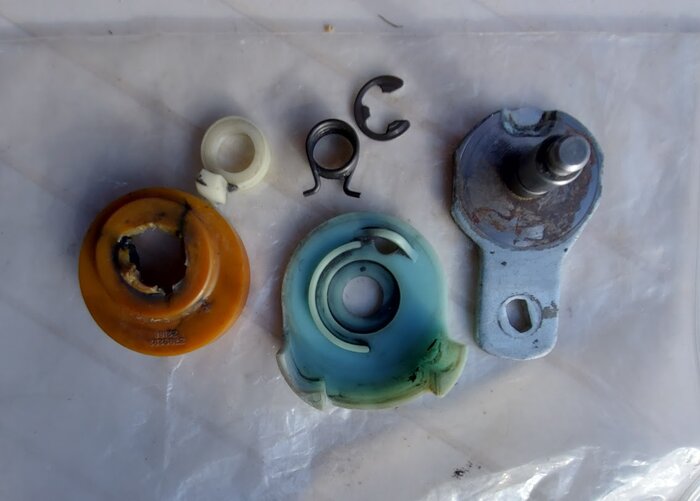

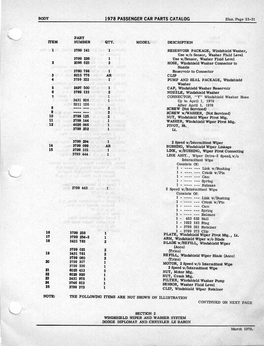

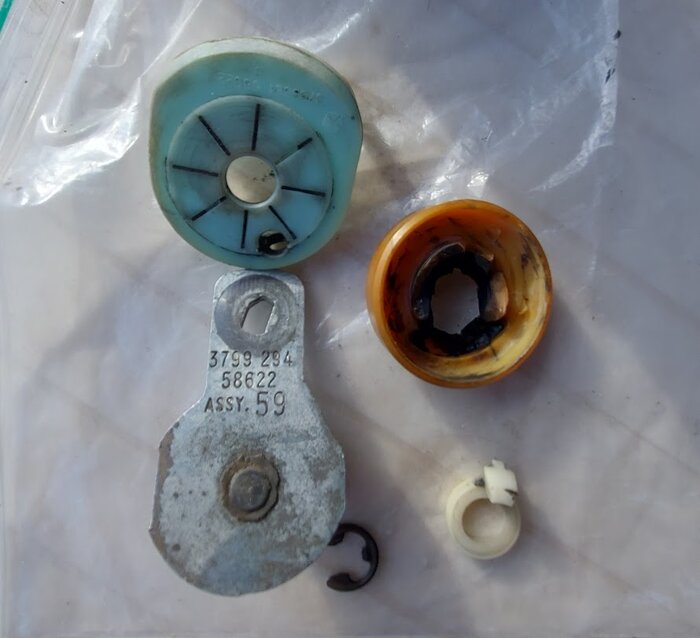

My old girl need a new bushing on the windscreen motor. I packed in and seem impossible to get hold of. I have noted that this is a special one and will not fit the one reproduced for Cordoba as per attached photo. From the Spares Manual I got hold of from Coller Dodge way back in the late 1990 I read Chrysler part number 3799 445

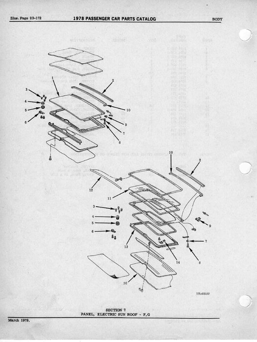

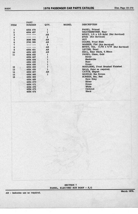

Any idea of where to obtain the small P-list on the rear of the sliding sunroof?

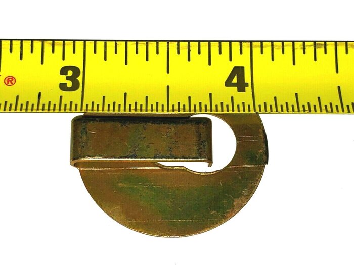

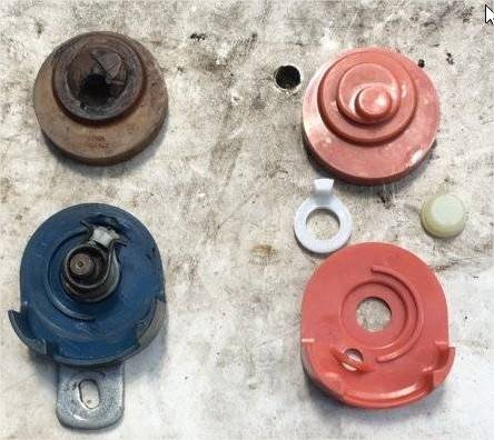

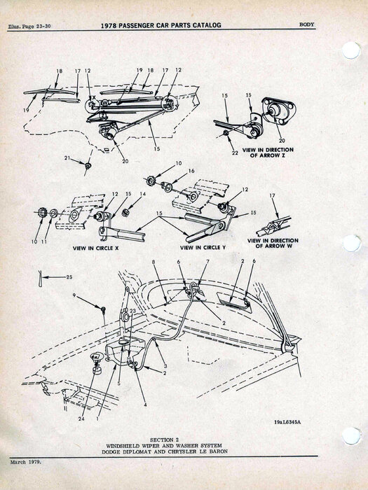

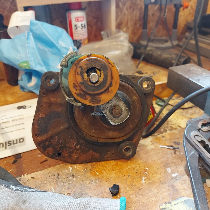

Thanks for your help but I am not sure they will fit as both lists does not state Diplomat, only Aspen. You are correct about me getting one picture from the B and C forum. This is the broken one on my car and the position of the ball is different. I will of course drop the sellers a line asking them but I miss a lockwasher or am I wrong?
1,421
574
Maybe it's a bushing problem that is listed wrong. Aspen and diplomat use the same mechanical parts. The only difference would be if there's a difference between 2 speed and variable speed ones.
You might be best off getting the wiper motor for a newer one instead if fixing the existing one.
