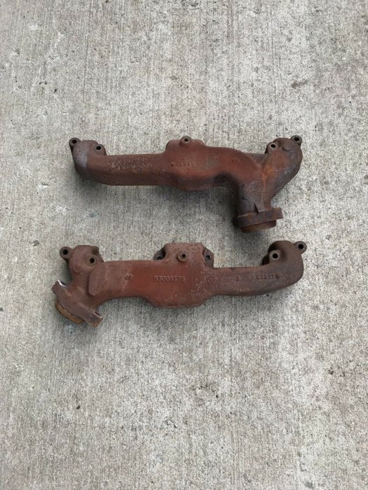

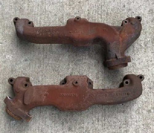

Thanks. I've seen someone running shorties on these before. Do all A-Body shorties fit?

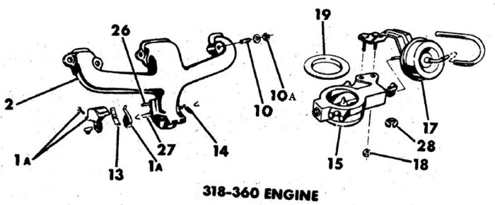

That is a pair of Jeep Grand Cherokee Magnum manifolds.
To the original question, those manifolds will fit and work fine with a couple of exceptions:
- The exhaust connection will be in slightly different position – so some minor exhaust work will be needed.

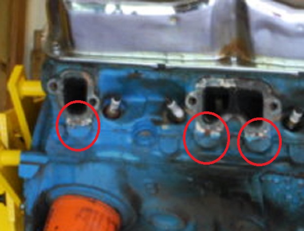

- The A.I.R. ports on your cylinder heads will need to be plugged first (if applicable).

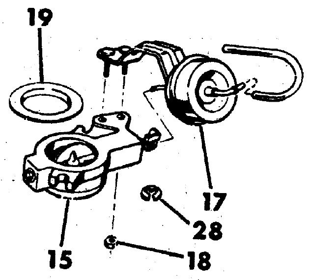

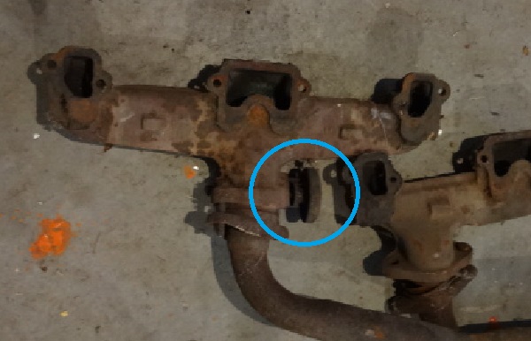

- Need to find a way for a heat manifold – if you plan on driving a lot in frozen temperatures (32’ F / 0’ C).

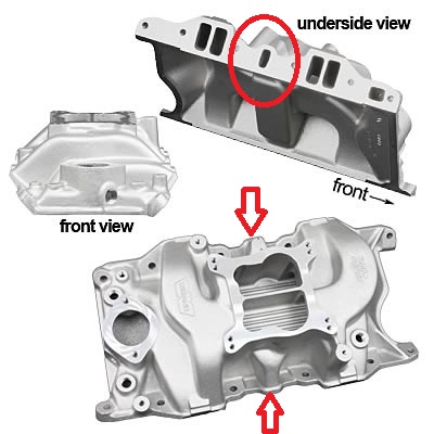

The A.I.R. ports look like:
Not a very good picture.
