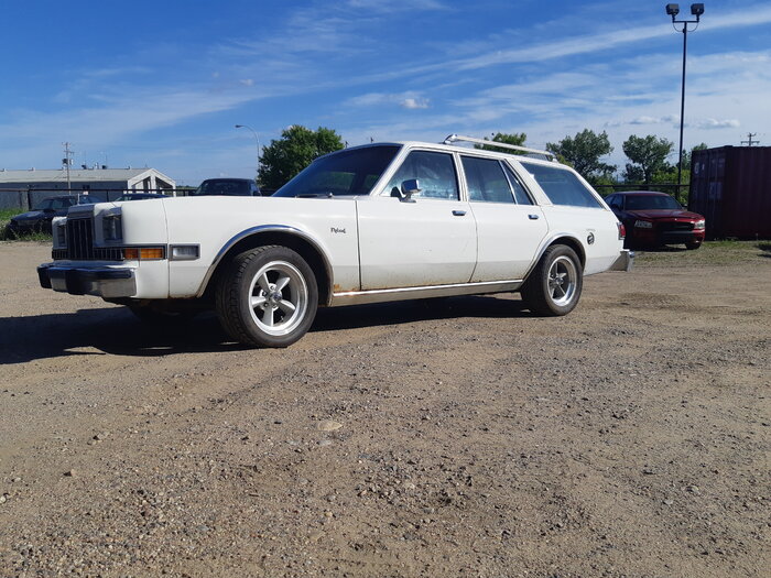

I have an 81 diplomat wagon and i was wondering if there is some other car i could get a window regulator from, its manual windows and the gears are stripped. I found lots of fifth avenues around but they are all power windows, dont know if that would work.

Power regulator is different than manual. F and M body wagons and 4 door sedans all have the same window regulators, it may be easier to find a manual one in an Aspen or Volare.
