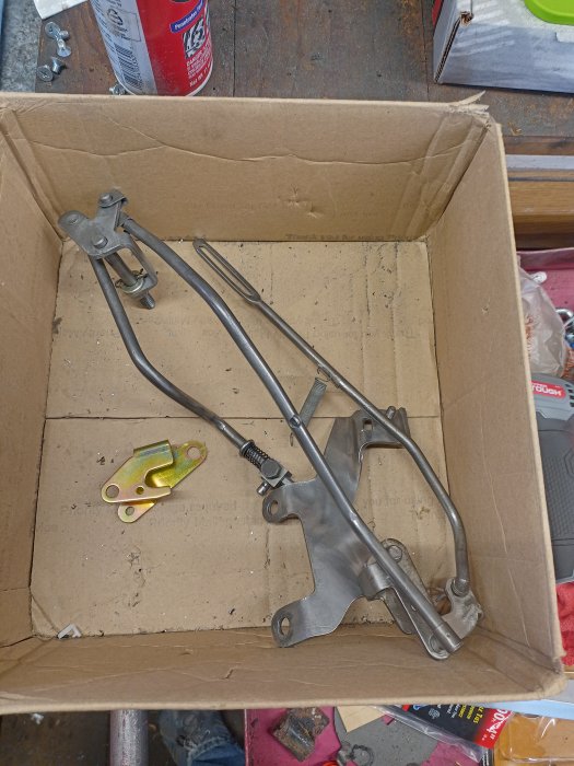

Four barrel FMJ kickdown linkage, intake bracket and Edelbrock carb throttle lever. Just found this while digging for other parts
That there is unobtanium. If you're selling it this guy should pick it up.
