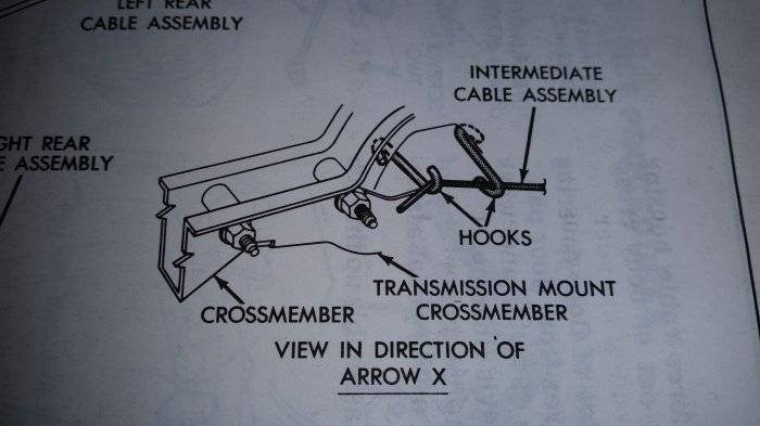

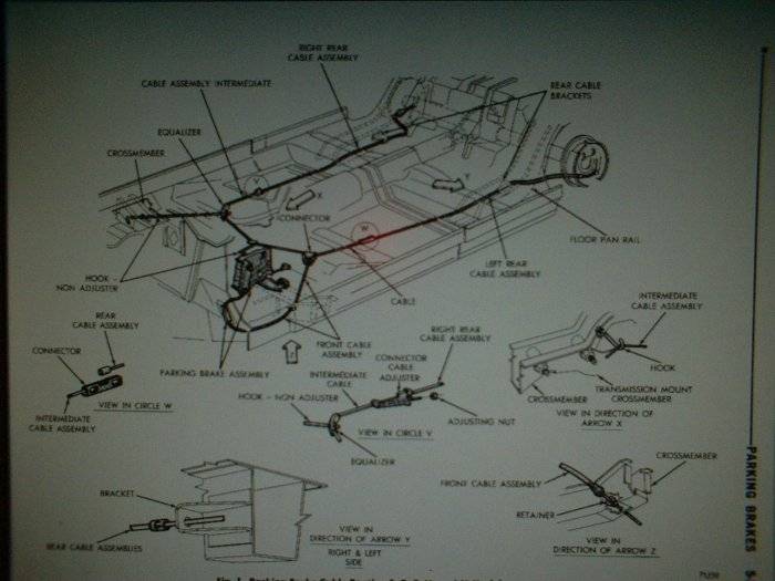

Here's the illustration from the '79 service manual.

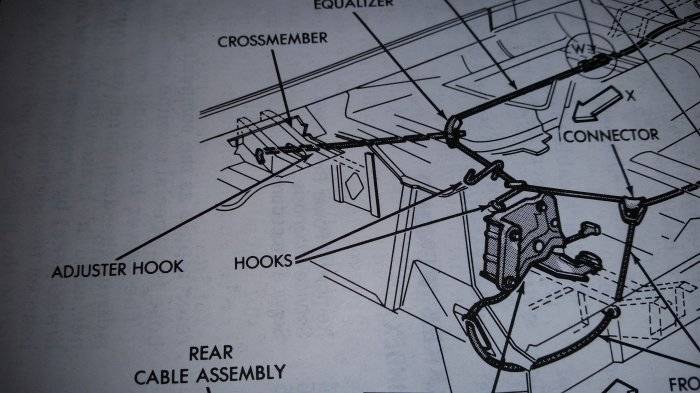

These pictures are from an ’84 factory service manual (FSM) and is slightly different.
The “S” hook is not shown very well in the above picture (nothing with Aspen 500 – but the manual itself) for is kinda hidden by the Park Brake Petal.
The Pictures don’t show the transmission tail housing which is also a missing part of the whole scheme of things.
This is not from the year you are looking for – but may help you out.
