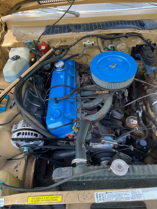

It is a tan 1980 Dodge Aspen, 225 slant six, sedan, as base model as they came. 904 transmission, 8.25 one wheel wonder rear end. $2500. Dude was asking $3500. This current Aspen is in better shape than the one I owned in 1994. I'm probably not going to paint this one flat black, probably.
I did already blow the 225 up a few weeks ago, rod right through the side.

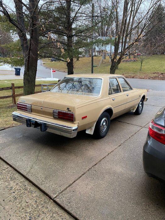

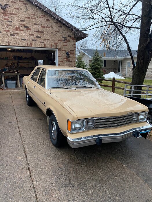

Here's a couple pics of my ride. Or maybe it'll be my son's ride, who knows. I'll probably just have to get a second one, i'll get him a coupe.

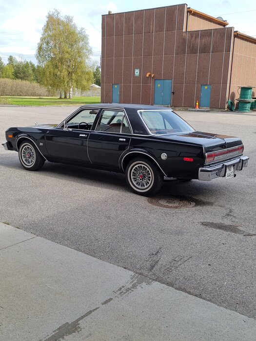

Your story is a lot like mine except my Aspen is the one I had when I was 20 years old.
I stored it in a barn when I upgraded in a newer car in the late nineties. With a bit more know-how and better economy I finally can give it the attention it should have gotten 25 years ago.
So far I did a Magnum swap, rebuilt the 904, new brakes, exhaust, gas tank, repaint, wheels and a front suspension rebuild. (and probably some more...)
Next on my list is a rear suspension rebuild and a new vinyl roof.
Here's a picture of it:

Snowflake wheels look great on your Special Edition.

Beautiful car. Looks great with those wheels, and the paint is nice. I bet it handles good too.

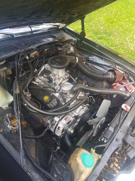

I converted the Magnum to carburetor, v-belts and mechanical fuel pump.
There is not alot of Magnums in the market here in Norway, and the one i got hold of didn't come with the electronics for the FI.
I wanted a 5.9 but had to settle for a 5.2. It had 90.000 miles on it and was in good shape so all in all I'm happy with it.

Looks like a clean motor, with the 90,000 miles you probably didn't need to rebuild or anything. Around here some guys put new tops on 200,000 mile magnums and run them with mild builds. Sounds like a deal. Looks like a clean install. Again; your car looks beautiful.
