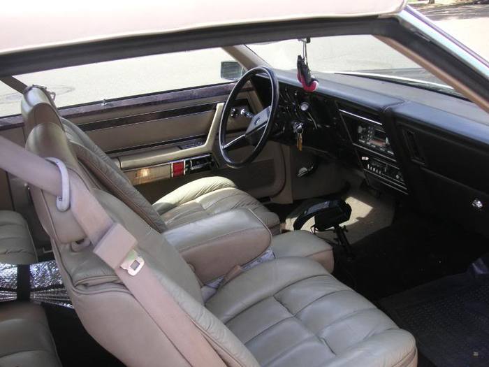

Dark brown w/ light tan factory fake convertible top. Beautiful light tan leather interior. Leather is like new, soft, no tears or cracks. No cracks on dash. Beautiful interior!

Dig the old car phone!
If I knew the "Keypad Unlock" code, it would at least be able to dial 911 ! It still turns on.
