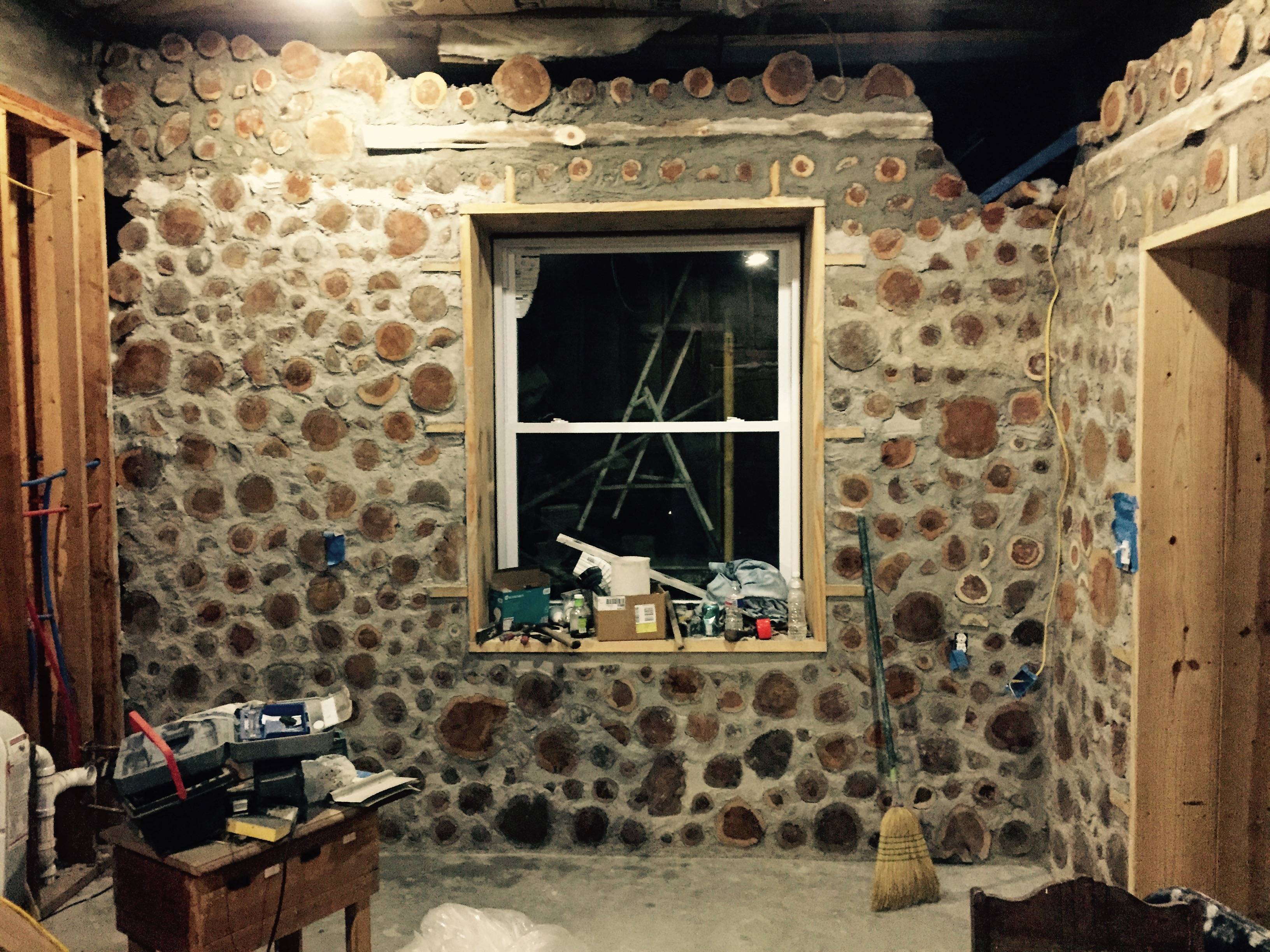

We decided to build a house out here and had the professionals help us with the 2nd floor. Meanwhile the first floor had no walls.
So, October, November, December including Christmas eve and Christmas day I'm out there making concrete, moving logs, and setting walls-windows-electric to get the walls done before cold weather hit.
I did get some great help from my brother. He took over mixing the concrete (one drum at a time). Then I only had to move 192 drums of concrete, place it in the walls, set the logs, fill in the insulation and repeat til the walls were done.
