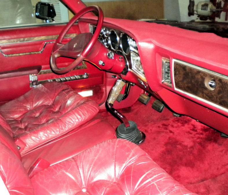

I converted my '87 Fifth using F body components. Most of it is drop in. Issues encountered were small and easy to overcome - relocate high beam switch to floor and fabricate a "Z" bar ball stud pivot that attaches to the bellhousing. Take your time - you will enjoy your M much more.
