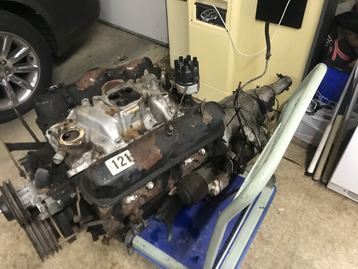

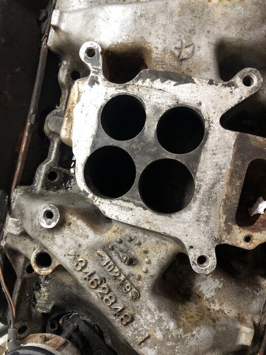

I used a thermoquad (with adapter plate) on this 318 cast iron 4-bbl intake. Yes it does weigh more than the engine! Lol
That casting number is for a 1970 340.
Numbers I have:
1970 340 4 bbl casting number 3462848
1971 340 4 bbl casting number 3512100
1972 340 4 bbl casting number 3614025
1972 340 4 bbl casting number 3671918 has N95 evaporative emission control
1973 340 4 bbl casting number 3671918
1974 360 4 bbl casting number 3698434
