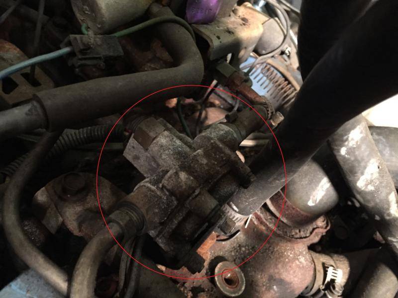

3) Speaking of lines going back to the rear: There's a what appears to be a fuel return hose coming off this doo-hickey on top of the manifold ( circled in red ):
Can I just plug this return line and remove this device, or what do I need to do? I don't really need a return line, do I?
