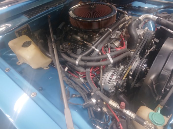

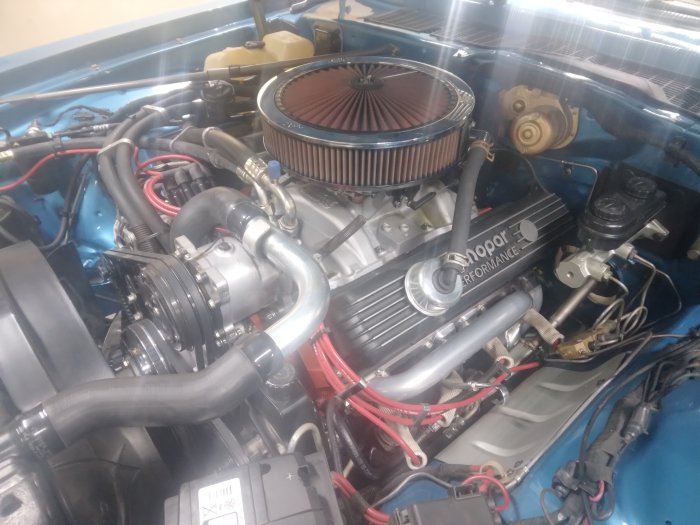

For reference, the 440 (actually 500) in my Aspen. With a low rise intake, and 1/2" carb spacer, the air cleaner wing nut JUST sticks into the scoop opening.

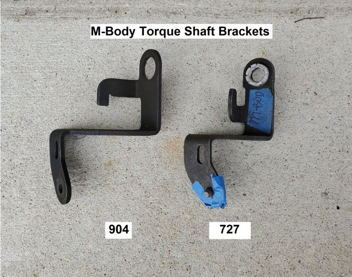

How about the trans mounting? Anything needed extra for the 727s? Again, just constructing a shopping list.... thanks.
Reggie
Apr 23, 2018
46
23
Maryland
727 torque shaft support bracket (on right) is narrower than the 904 bracket (on left).
Mikes5thAve
Mar 3, 2020
1,791
745
Yes the bracket at the transmission is different for 727 and the last kick down rod is different also. Same with dipstick tube if it doesn't come with one.

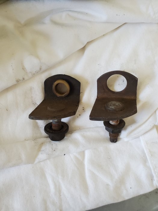

You will also need to shorten your driveshaft as the 727 is longer that the 904. However, before you start measuring, you will want to swap in a stronger rear axle housing than the stock 7.25" unit. Forgot to mention that the older short style 727 TS bracket should work as well but my experience is with the later M-Body style bracket .
