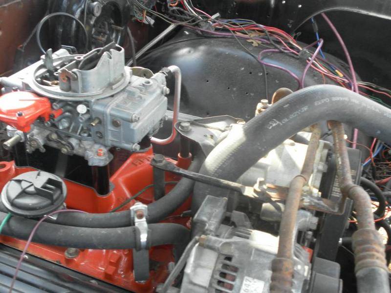

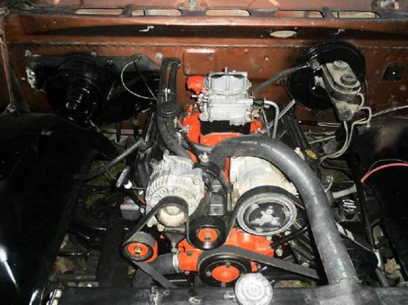

I'm surprised that nobody has talked about a Magnum motor swap. Bolts in stock location of an LA motor. You get gains compared from the stock LA 318, 360 motors that came in the FJM bodies:
Availability from 1992-2003
Reasonably priced
Increased HP
Better flowing heads
Roller Cam
EFI
OD if u choose to use the A500 or A518
