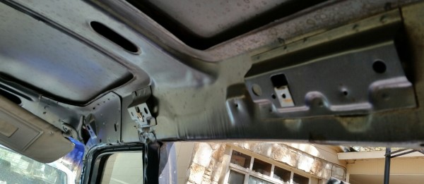

Before I take the headliner out again does someone have a bare ceiling they could take pictures off so I can line up the grab handle. Especially above the center pillar
And does the grap bar stick out a couple of inches from the headliner. Obviously in my initial enthusiasm I didn't take pictures

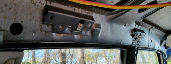

I don’t know where my old grab handles are (hand meets forehead), but sense I don’t have my headliner in car yet (see earlier thread) I did take pictures of both sides of roof area for you. I do not think I’m missing any push nuts (proper term?).

Note: I have four nuts, two per side. One of which is in center of B pillar.
Thanks muchly for the photos.

Notice in BudW's photo above there is a larger hole and there is (probably rusted) hole for a screw and a small hole next to that. The large hole has nothing to do with this process. Its the one you can feel the easiest, but making a hole in your new headliner for that just makes you irritated that you spent all this time but didn't correctly mark the holes and now have an extra one at that location. Bleh!
Also, if you do add a radiant barrier, which I did. Please pay attention to where you put the cut outs so you can get to the roof screw holes easier. I spent a lot of prep time marking holes and cutting away radiant barrier --including the foil so this would go smoothly. Only problem was, I had turned the barrier upside down from how I was going to install it. Doh! So my cut outs where in the wrong place. Which means BudW's picture suddenly gave me great insight. I had everything right, but because I turned the radiant barrier over, I precut it wrong. So my 'guide' for hole location was wrong and nothing line up when I tried doing this by feel the first time.
