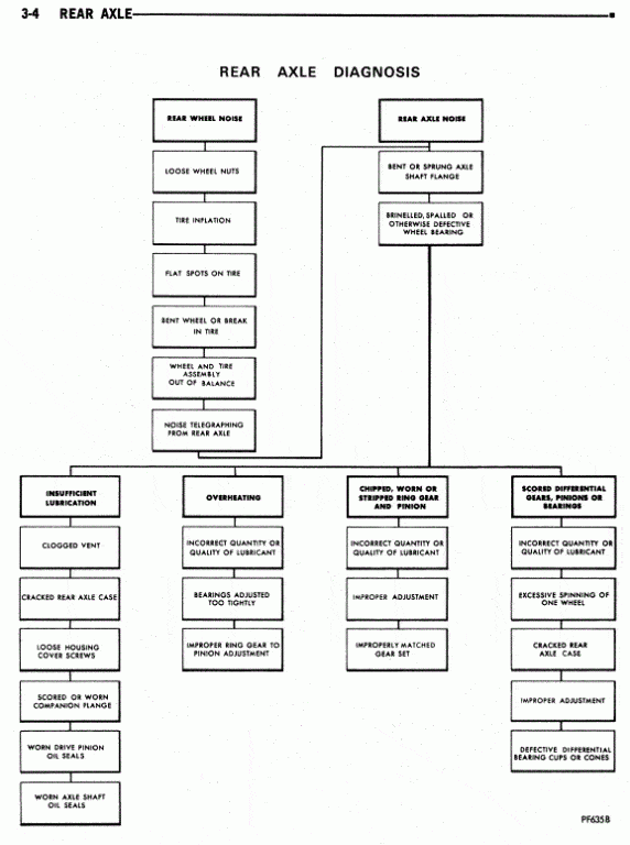

Im thinking I have a rear outer bearing starting to go out on my 77.
Any idea what the outer bearing number is?

look for (Mopar) 3420091.
NOS 1966-1984 V,L,H,N 7 1/4 pair r/wheel brgs 3420091
