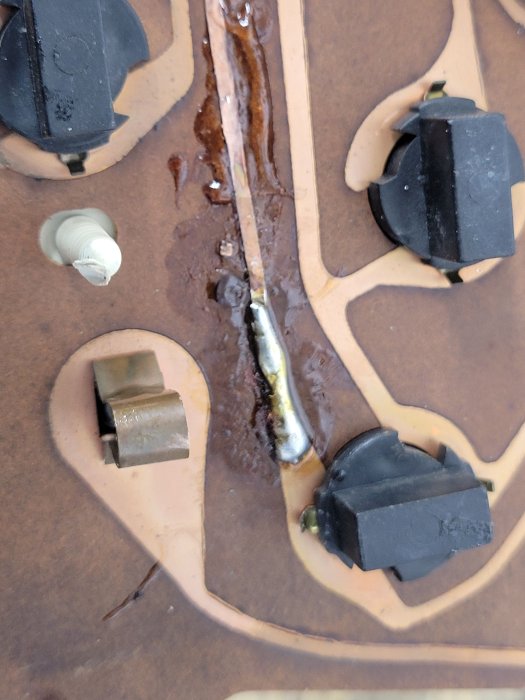

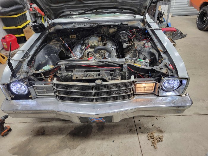

Last time I posted about this car I was trying to figure out why I had no headlights. Turns out that at some time the bulkhead connector and been separated. When put back together it was done crooked and damaged 3 of the contacts.

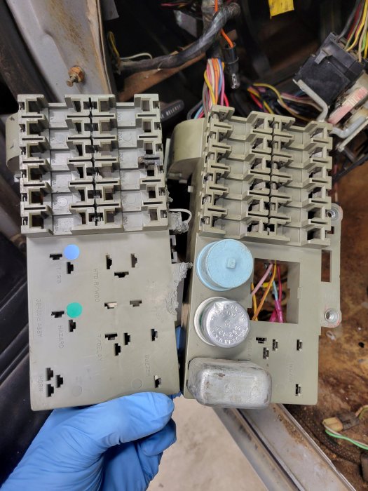

I built bypasses and now headlights work and so does the dash. The fuse block had been damaged so I moved all the connectors to another fuseblock I had laying around. 76 and 77 fuse block is very close. 76 on the left, 77 on the right.
