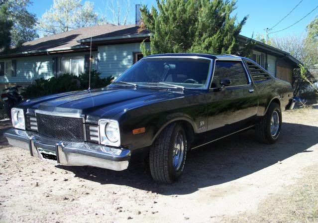

Anyway, more pics and details to come in other threads, but this is an older photo of the whole car with skinny rear tires:

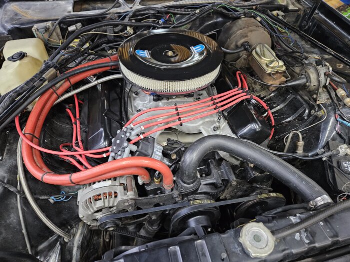

And the new 511 CI fuel injected motor:
