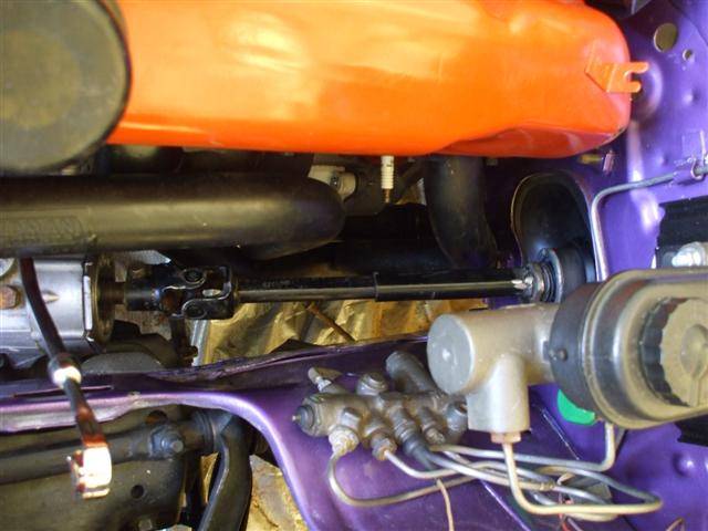

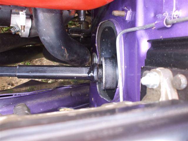

Check out my wagon in the project section. I got a 440 with B body headers. Im running manual steering on mine but the headers will interfere with the steering column coupler and one of the studs that hold the steering column to the floor. I used part of the steering shaft from a 92 Jeep cherokee. I used a bumper bolt on the bottom column after knocking the welded square nut off.
