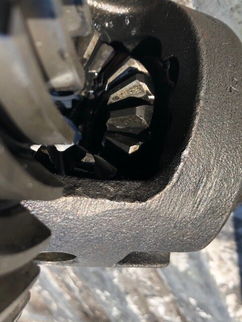

are the Trac lok carriers rebuild able? I see rebuild kits for the dana 35 but haven't seen any for a 8 1/4? Overall the carrier is in decent shape but I did see some scrapes in the center of a couple teeth in the spider gears nothing big. Didn't know if this was something to be super concerned about? I can try and post a few pics of what I have.

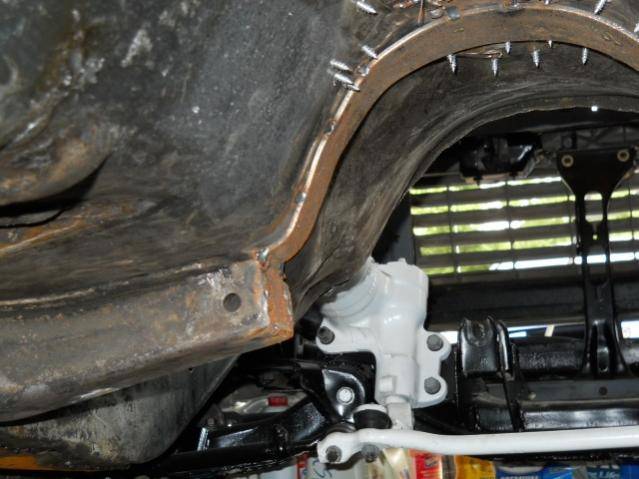

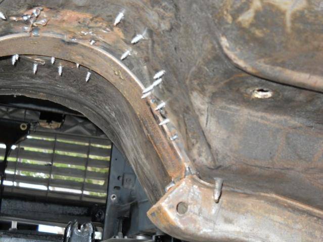

No tunnel massaging is required to fit. The forward half of the 500 is exactly like a 904. The cross member is your problem as it interferes with the OD section (tail shaft) of the transmission. That cross member needs to be flush the sheet metal and while I've seen a few different takes on it, the easiest is to remove it, cut a channel out and put in a piece of formed box tube in its place. This will make the cross member poke up through the top of the floor rather than hang down under the sheet metal. Carpet covers it and you would never know it's there.
You can modify your existing transmission mount or build a new one. The rubber is GM universal piece that bolts right to the bottom of the transmission.
You are going to need a welder and an angle grinder with cutting wheels. A drill too to get the spot welds out. This isn't that bad of a job really. If you know someone with fabrication experience and a garage you can have it done over a weekend.
what mine looks like, ignore the screws.
Wondering if you have before and after pics? I was trying to find your thread on this conversion.
Also, Curious what were all the screws used for? Thanks
The screw held various items and covers to the floor, they are going to be welded up soon. Unfortunately I do t think I have the before pic

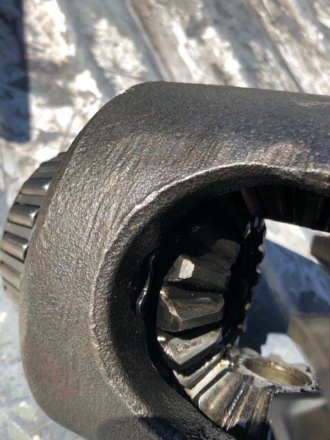

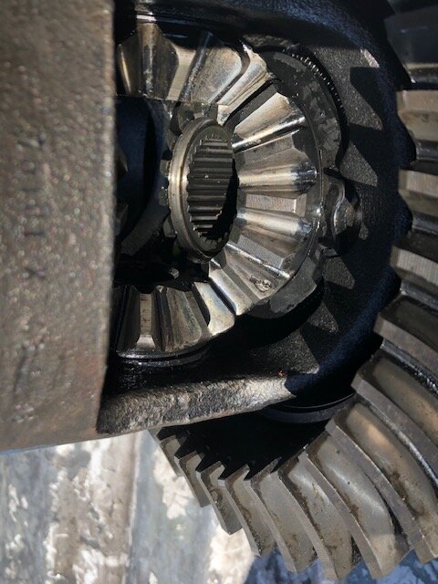

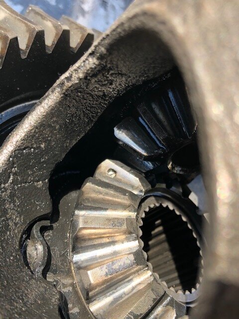

I was able to take some pics of the 8.25 carrier out of the dakota. Upon closer inspection I found some interesting wear in the spider gears. I'm wondering if they could cause issues down the road and should go another route for a LSD if I cant find a rebuild kit? I know there's new units for around $350-400 but, didn't want to get my hopes up and invest anymore in it if this isnt a worthwhile option.
