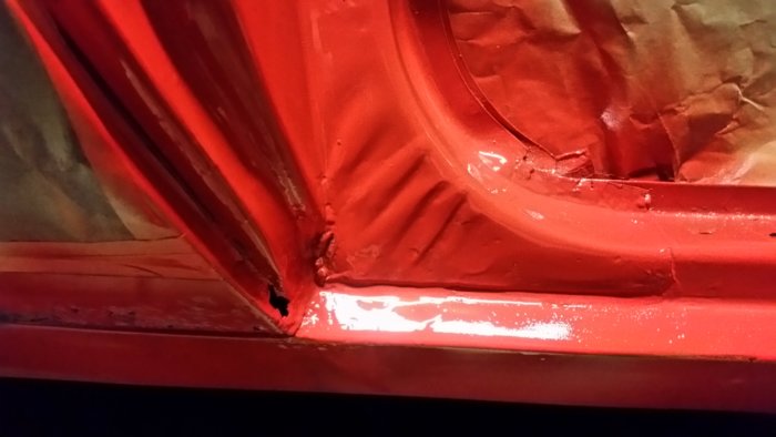

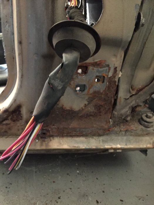

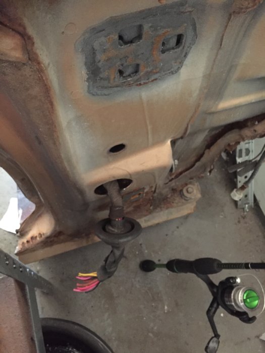

Well her is a picture of the passenger pillar. Lost of rust down at the bottom and and someone had patched the inside floor at one time. Hard to say how it would clean up as I suspect it may be riddled with pinholes once ground down or blasted

Thats the passenger side? it looks about the shape mine is in currently, except i have a hole right through but not much different, except i need the driver side. I guess JIM AZ has one im just waiting for him to get back to me. Im still looking for a floor pan though, he says any M body floor should work. Im assuming i would need a 2 Door M Body, which is actually harder than you think to find. All the M body 2 door cars in Canada that i looked at, people want too much...i guess 2 door fifth avenues and diplomats have become somewhat of a collectible aswell.
Regarding the bottom pillar though, i suspect this area is used to channel water away from the floorboard to the ground through the fender/hood gap and engine cowl/windshield. If they are not treated properly or checked for surface rust regularly, beware! i was naive to think because i dont drive the car in winter and try my best to avoid rainy days that would be enough to preserve this car...i guess i was wrong, car washes can wreak havoc aswell. Check these areas once a season! Ill be treating whats left of mine with POR-15 for the time being.

That rusted area at the bottom of the pillar, the fender traps leaves and gunk there and then it constantly gets wet from water coming down thru that fender-door-cowl gap. I've seen some that have rot in the inside which I would guess is from the cowl starting to leak down there over time.
For the floor someone can correct me if I'm wring but I thoguht the M body coupes are the same wheelbase as the 4 door ones so the M coupe floor would also be different then yours.

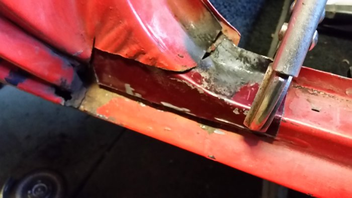

I just saved a driver side lower. Not sure if the whole thing was good in the area behind the fender or I was just saving it for the rolled shape where it meets the rocker in the jamb. But my most recent experience in shipping a batch of parts from US to NS didn't go so well. Not only was it triple the shipping cost of anywhere I could have sent it in continental US to get it into Canada, but then it sat in Customs for weeks, assuming it was quarantined. Then he said he had to pay an additional $60. I had thought the absurd shipping price covered the customs fees, but apparently not. The package was insured for his full purchase price plus shipping in case it did get lost and we thought it may have when it got stalled. But it did show up and turned out to cost him so much more than it should have. At least it was hard to find parts and not something that would have been easy to source from within your country.
The side where it overlaps the rocker shouldn't be too bad to just hammer shape steel over wood forms. So what if you don't also hammer out the triangle shape back at the door jamb roll. But you could with a recess cut into the wood block, by hammering a socket extension onto the steel and pushing it into the recess. It's labor intensive but I've done that type of work many times before having proper tools.
For the jamb roll itself, I had nothing for the rear jamb and sourced one from a late model back a few years ago. It would be the same concept. I made a carboard template of the shape as it rolled in, and just kept trying it to different cars in the yard until I found one close enough that I could force it the rest of the way. Welded it in and connected it to the rest of what I'd made. I couldn't do the exterior of my quarter panel at the time so painted it to hold for a while. But I couldn't cut the exterior of the quarter off either, until I had the jamb solid again and Something was holding it all to the rocker. I actually filled the metal folds where they remained with weld right to the late model flat steel face I had. Then finished their lower sections back in with Bondo to complete the look. It's functional and even though it wasn't perfect at the time, it got the job done so the next step could begin later. Here's a pic of trial fitting, and also of the finish at that time.
