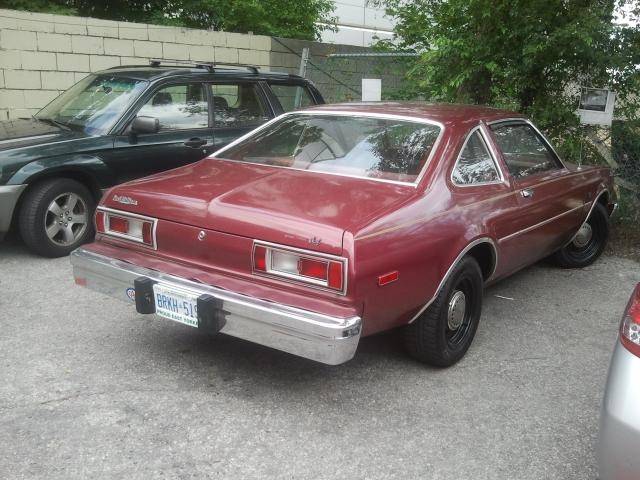

I thought that part of the 1980 F body restyle they went with M body bumpers...which means that it should be like a 5th Ave.
Mr C
Apr 22, 2014
408
142
They look like M body bumpers to me...albeit without the rub strip.
They will fit...just not correct for a 79.
