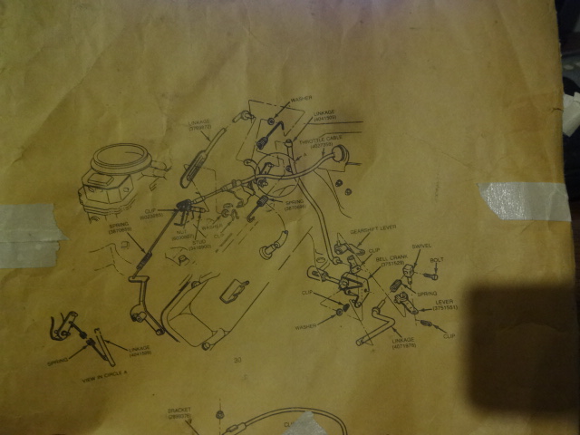

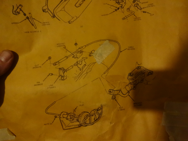

You folks tell me if this even sounds semi correct as I bought this packet of parts simply for parts but ive not robbed anything from it yet.
I put the parts out of the big envelope into a smaller bin but I can take pics.
Sorry if this is of no use.

Need to see pics of the parts. From the diagrams it could be anything related to those diagrams and the original conversion kit had a lot more.

I will pull it out in the AM, its 90% of the parts in the diagram and I thought it was some sort of kit from the start. Most have individual part number tags on them as well.
