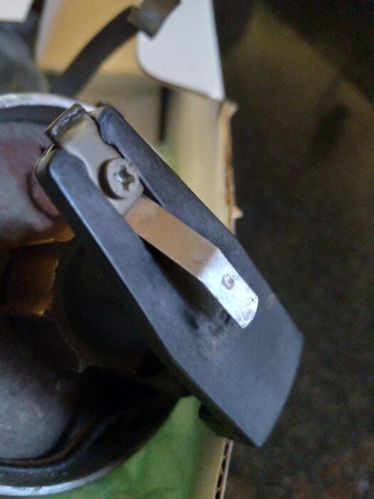

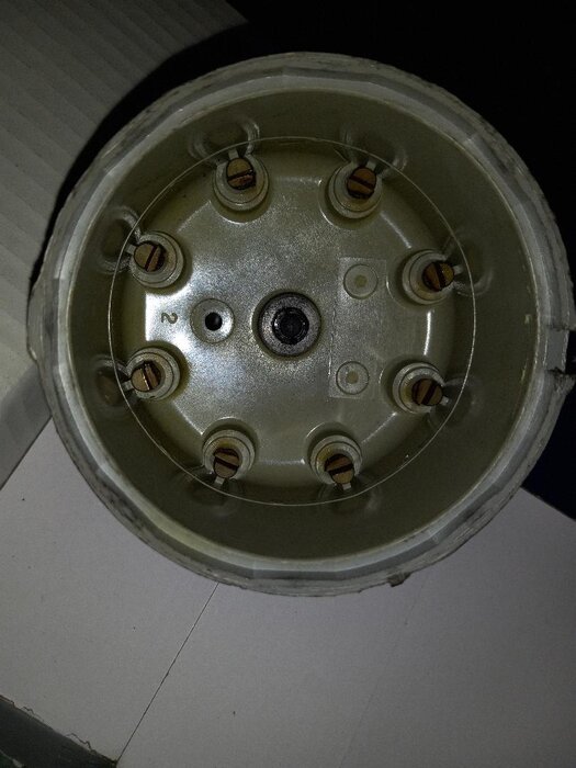

Well I'll be a monkey's uncle, that worked. I've see rotors break before, but both the cap and rotor looked OK, nothing obviously broken. (See the pictures). And it was so weird that it literally went from just fine to zero spark overnight. Also the cap and rotor had only ~10,000 miles on them. But whatever, it works now. Thank you ever so much for the good advice!

2,991
I've found many times over the years, a visual on a cap and rotor means nothing. At work, can't tell you how many older Vortech 4.2L or 5.7L GM trucks came in as a no start. Those are the ones with the flat cap and plug wires out the sides. The cap would look like new but replace it and the engine would fire right up. Same with ones that still ran, but ran rough, backfired and misfired. In every case, cap LOOKED good as new.
