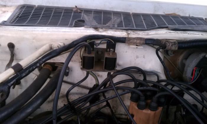

Also, the 2 solenoids on the firewall behind the distributor, one is for purge and the other for the EGR. However the sticker under the hood is unclear as to which is which. I am about 75% sure I have the hooked up right, or at least the same as they were when it was running properly, but I am getting less and less certain. Can someone clarify this for me?

Here are the 2 solenoids on the firewall I was talking about. Not sure which is the EGR and which is the ASRV.
