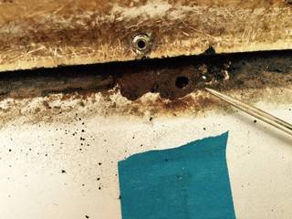

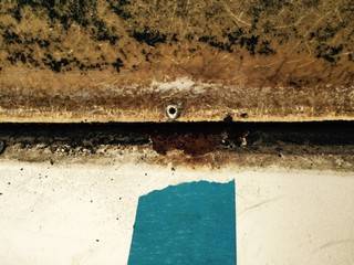

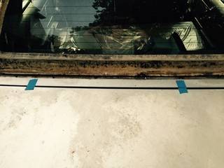

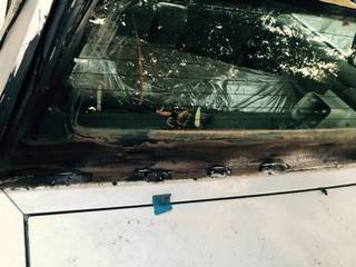

This is a view from the rear of the car at the back window. The blue painters tape indicates places with rust at the edge of the fiberglass bonnet.
I quickly checked both spots and thought things were good to proceed with limited additional effort other than a little rust removal.

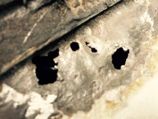

Based on advice from smarter forum folks, I went back and spent more time with a different tool (awl) and pressed on all the rust areas and guess what:
The point of the awl is pointing at the hole I made when I pressed in that area.
This particular section where the bonnet meets the body is a single piece of metal; that is, it isn't a sandwich top and bottom like the hood. So that hole, which will be covered by the vinyl and the chrome trim, actually goes all the way into the trunk.
I cannot just leave it and I cannot fix it with the bonnet on it. So folks, this thread will detail removing the bonnet from my 87 Fifth Avenue and repairing the rust spots.

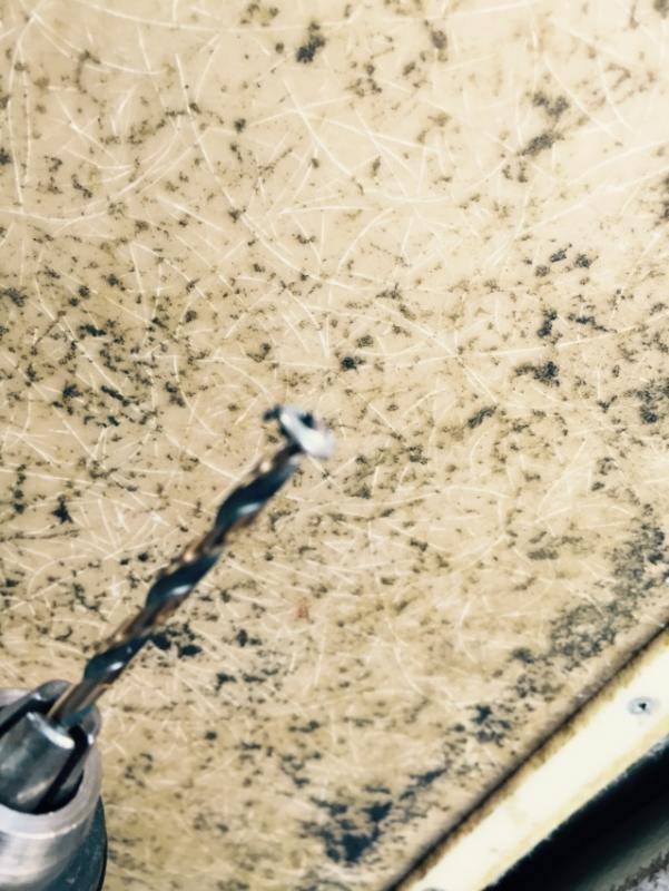

Life has been getting in the way of bonnet removal but I snuck in some time today.

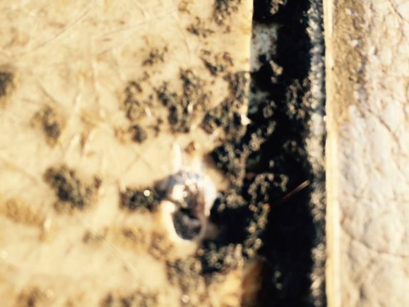

These were the heads of rivets I drilled today. Even being super careful, you can see that both these locations had cracked fiberglass (bonnet). One tore out the fiberglass, the other didn't.
Course, after 8 steel rivets my drill bit was toast. Will get more bits tomorrow so I can get the bonnet off and the repairs done while the weather is nice.

Busy day ahead so I worked on removing bonnet this morning. Here are the details.
Bought more drill bits yesterday. It took me a total of 5 drill bits (9/64). Got about 6 rivets to each drill bit before they became dull. These be steel rivets, no aluminum here.

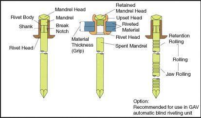

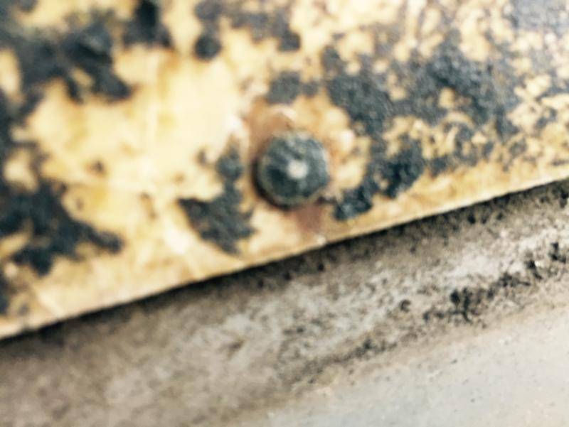

The rivet:
The first rivet in this picture is like the ones you have holding the bonnet to the roof. Your goal is NOT to drill it from the top of the rivet all the way down the mandrel.
Rather your goal is to drill enough of the center so that the rivet head (the collar) comes off. I started with very small diameter bits and kept going up in size until I found the one that worked best for me. If your drill bit is too small, you don't catch enough rivet material to make the head of the rivet come loose. If you have a drill bit too large, you make a larger hole in underlying material and have to get an even larger rivet to replace it.
These were the problems and solutions I used:
1. A rivet with no indentation at the top, so I didn't have a 'guide' for my drill bit and it kept trying to wander off onto sheet metal. Take a punch or nail and use a hammer to drive it into the top hard enough to create an indentation.

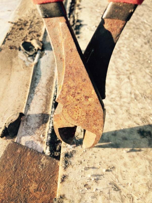

2. A rivet that I drilled too quickly and the bit wandered to the side of the rivet taking out part of the head (collar) and part of the fiberglass. I used a pair of dikes to nibble at the remaining part of the head until i could get it either small enough to pull the bonnet over it or completely nibbled off so didn't hold the bonnet any longer. Tedious, take your time. You'll still chip out some fiberglass.
3. A rivet that I drilled exactly in the center, went the same distance in depth as the others and all it did was rotate in a circle but never broke the mandrel body so the head (collar) would come off. Tried the dikes, tried a slight angle to the existing bit, finally used a bit one size larger and SLOWLY drilled so I didn't have to repair another fiberglass spot. Eventually the head broke loose.

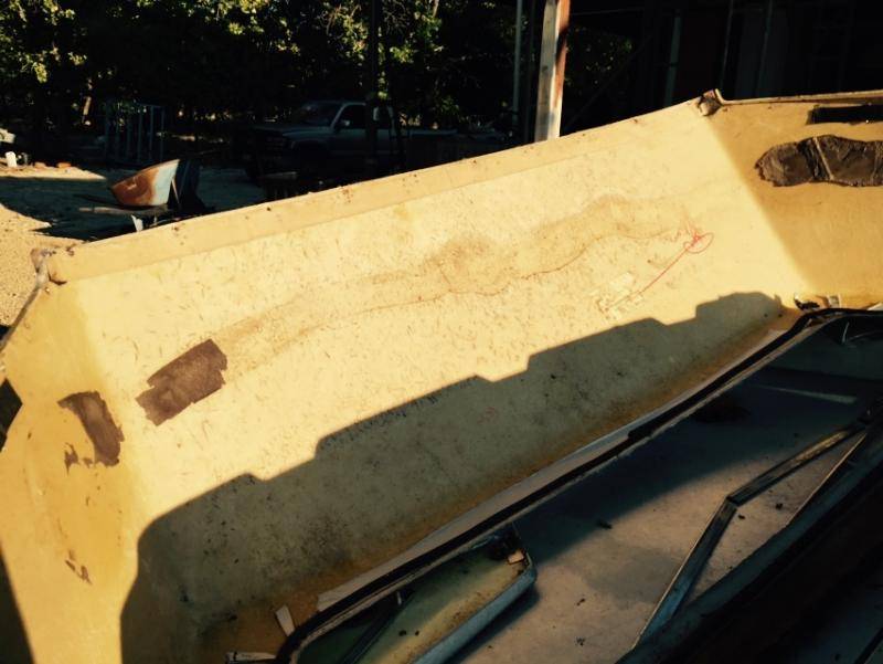

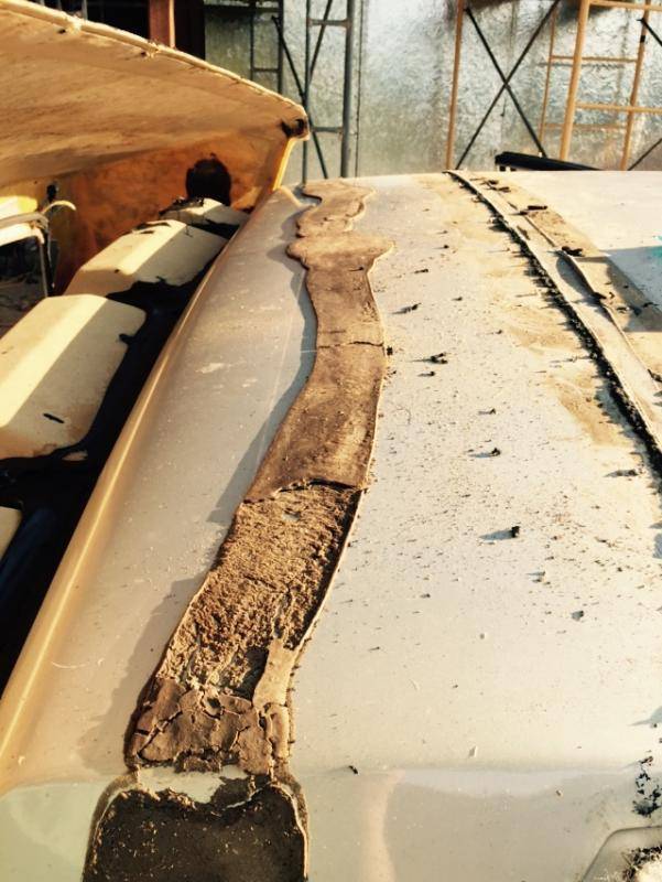

Messed up the fiberglass bonnet here.

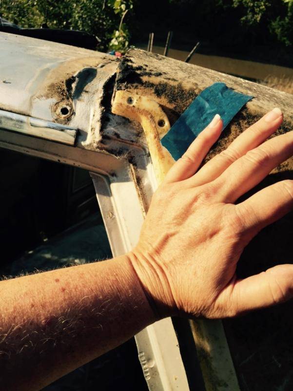

Once all the rivets are out, take your putty knife and work it under the edge of the bonnet, all the way around. Old gooey, dried, black adhesive is there. You need to be sure the bonnet is pulled over every rivet, unless you take time to take a punch and hammer and push every rivet back through. Which I should have done but was to interested to find out what it looked like underneath to do that. ;)
Go to the upper, inside corner of the bonnet and push gently up at an angle. This has adhesive under it that is getting old but still has some stick to it. So you don't just grab the top and pull back. You don't just grab the bottom and pull up. You risk ripping the bonnet itself. The inside corner, where the vertical window meets the top of the roof has the highest tension. Once you get that area loosened, you can easily pull the bonnet.

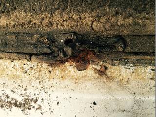

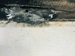

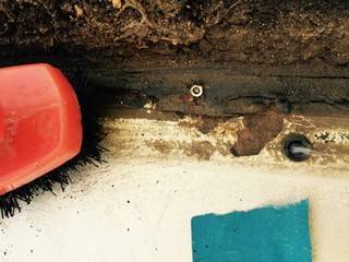

I used a nylon brush to sweep out some of the crumbs.

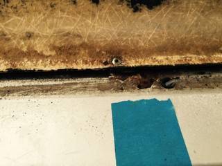

This rust spot looks pretty well contained. Wasn't any larger than first seen with the bonnet attached.
Used my left hand to take the picture so the orientation is opposite of the other one (my apologies). After cleaning the area, I poked at the steel with the drill bit and punched through more rust into the trunk. So it was well worth it to take the bonnet off and discover I had a larger rust issue.
Once I get the adhesive cleaned off, I'll see how big a patch I need to put in. Luckily I kept the old front crumpled fender so I have plenty of material to use in my repair.

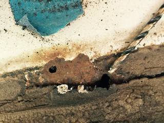

Then here are a couple of close ups after I used the putty knife to scrape away the sealer:
More rust
And more rust.
Then here is the underside of a couple. Inside the trunk, looking up at the holes:
This is the backside of one of the original problem areas on the left. I will have to patch this area.

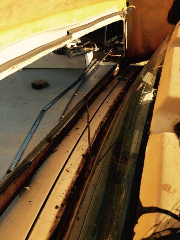

After this morning, I can tell you that :
1. The trunk of a fifth avenue can easily hold an adult
2. Lying in the trunk of a fifth avenue, you realize the tension rods for the trunk lid prevent you from using the full size wire wheel grinder.
3. Using a dremel with a wire wheel easily removes the surface rust right back into your face (wear glasses or goggles)
4. Getting into a fifth avenue trunk is far easier than getting out.
Pictures:

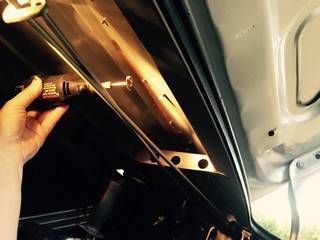

Lying in the trunk with camara pointed up there was about 2 feet of light surface rust in this recessed area. It looked like water was getting in around a rivet body and draining to the low side of the car to drip down. It was NOT the entire width of the car.
Best way to remove the rust was with a wire wheel attachment on a dremel. Lie on your back in the trunk and hold the tool up and behind the tension rods. There are plenty of brackets and those tension rods taking up space so you can't use a full size wire wheel effectively in the tight space.

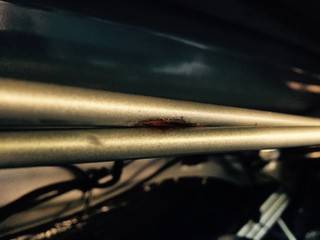

And look what else I found while in the trunk:
If you look carefully at the center of the image where the two tension rods cross, there is rust.

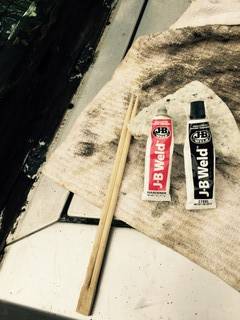

So I put up all my tools and welding gear and got out the JB Weld.
If you do try to repair the metal under the window with welding, you are going to have to use a welder with much finer heat controls than a 90 amp chicago welder from Northern that has Min and Max as the two options.

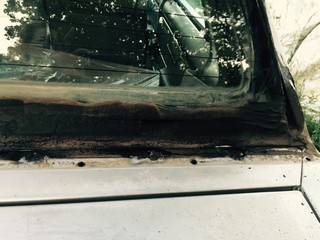

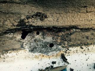

Original issue
After my attempt using the welder, you can see that the two holes (left one, right one) are larger. My welder has two settings (min and max). I used min but it was clearly too hot for the sheet metal near the window.
Backup plan:

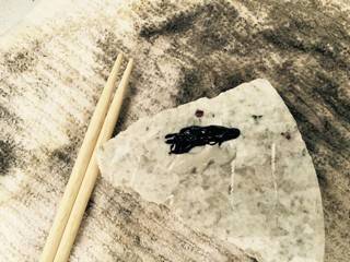

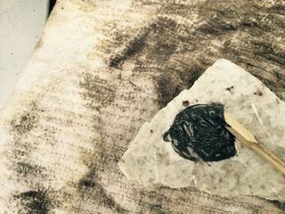

jb weld, chopsticks, towel and chunk of granite
Equal parts of jb weld (steel and hardener)
End result to spread

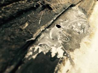

First round of jb weld (note the low area where the largest hole was)
Second round of jb weld building up to the level of the sheet metal.
Wait for it to cure tonight and bonnet can go back on.
