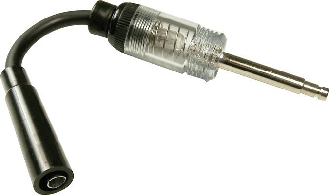

Have one of these to prove or disprove spark with ease.
Like 7 bucks.
