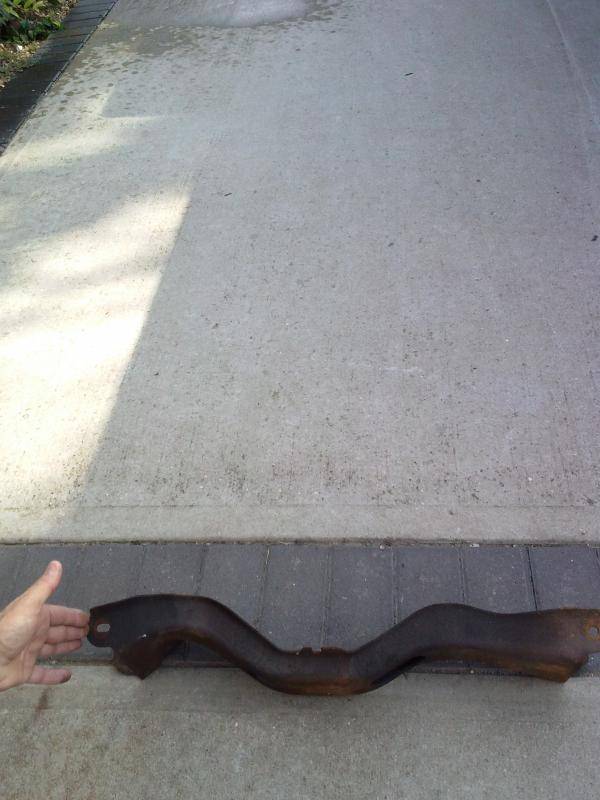

Unfortunately my other car broke down first so it didn’t mak it in the Garage. Trans is out. I’ve cut the crossmember brace out and have decided to go a different route with the trans mount. I’ll be using a modified butterfly style mount off of an 83 Cordoba. The floor shifter will not work with the 518 due to its width causing a clearance issue with the linkage.
You likely keep the floor shifter if you convert to a cable instead of factory linkage. I did it in my challenger.

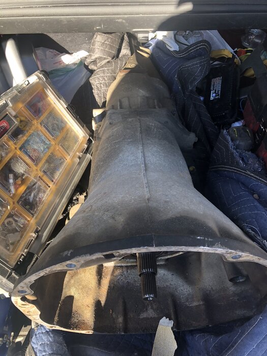

Latest update. I got the transmission installed and running. I took it out for a test drive. Got two miles and the trans went out. Got to take it out again! What a pain in the ass. Might have been my fault because I originally cut the driveshaft too short but not certain. I put a new shaft in the correct length but all I hear in the trans is a clicking noise. I decided to take the whole thing apart and paint the engine bay while I have the transmission out.

Got the transmission back. I ended up screwing it up by cutting the driveshaft too short and obliterating the rear bearing. Since I had to take the transmission I decided to take the engine out and redo the engine compartmen.
