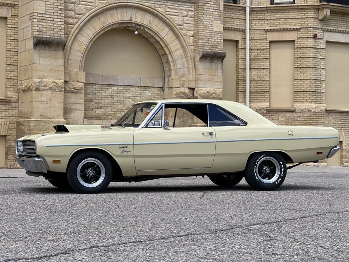

I bought a set and put them on my 69 dart. When they sent them, they sent 3 springs only charged me for 2, so I have an extra 003. I figured with the 20” front it would be too short. What do yall recommend? The 5th sags pretty bad.

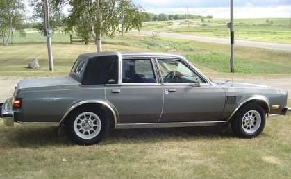

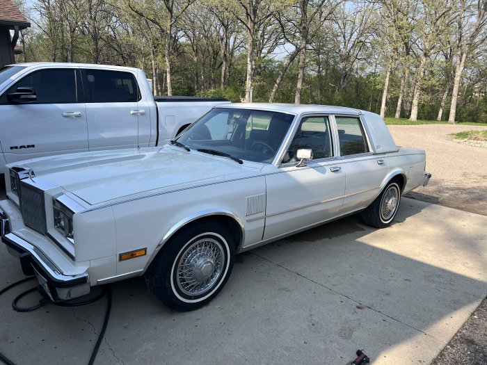

I sold the gray one a few years ago. I have the white one now. I have a b body 8 3/4 rearend out of a 68 charger, would this work on the car?

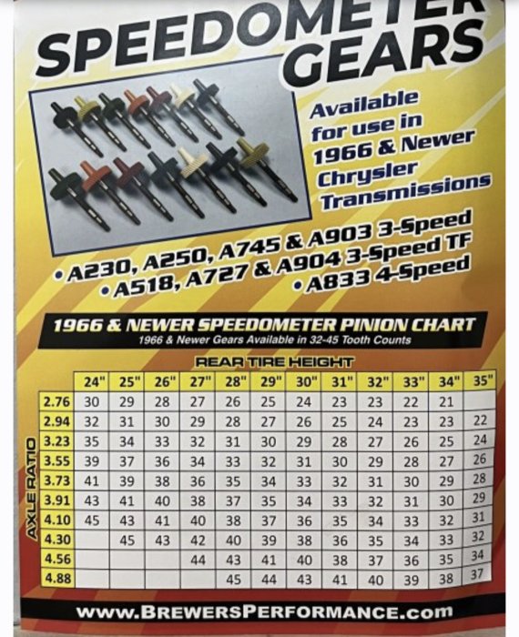

Cool thanks! What would i need to run for gears? I have a 742 w/ 3.23 suregrip.
27” factory tires with 3.23 gear ratio, you’d need a speedometer gear with 32 teeth for the speedometer to read correctly.

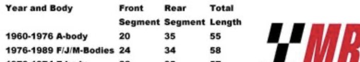

There is (or rather was) a MP fix for that: extra long spring front eye to chassis mounting bracket that allowed the use of SS springs in our rides.
You can occasinally find these on eBag or forums, search for MP part# P4120080.
2,992
.Mancini and Firm Feel have versions of the extended spring hangers. I checked MP and "Not available at this time, future availability unknown" I take that to mean never.
