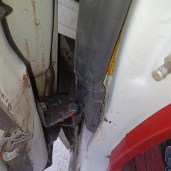

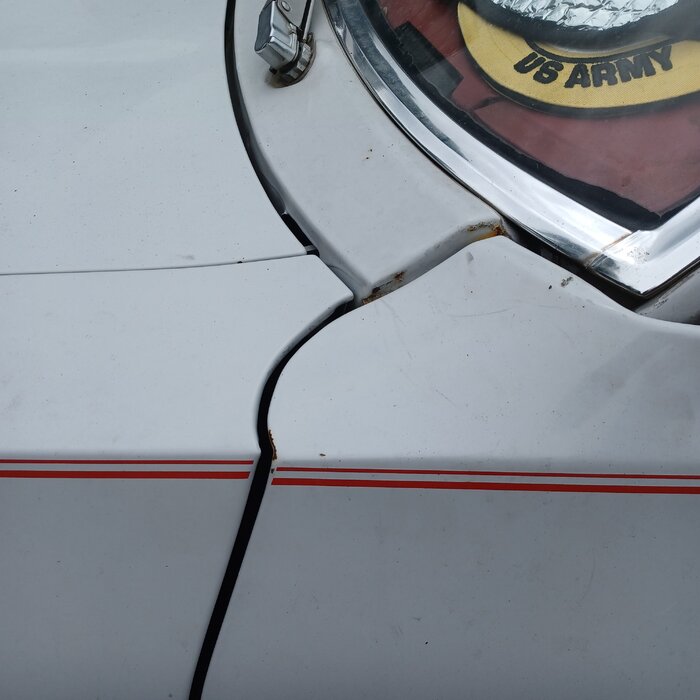

I've been having a problem since I have owned this car that the driver's door just doesn't want to shut right. I have done everything that I learned from Donald Brown back when I worked at his Bodyshop in the 80s. I the kid said that had the car before me. Had put a different door hinge on it and I don't know if it's the shims or what. but between that and thinking that I have to overhale the trans because he drove it from one side of Canadia to the other with a bad pump seal and low cherry juice now she shudders on acceleration. I guess that I'll just have to make room in the garage to yank and o/h or just r/r.

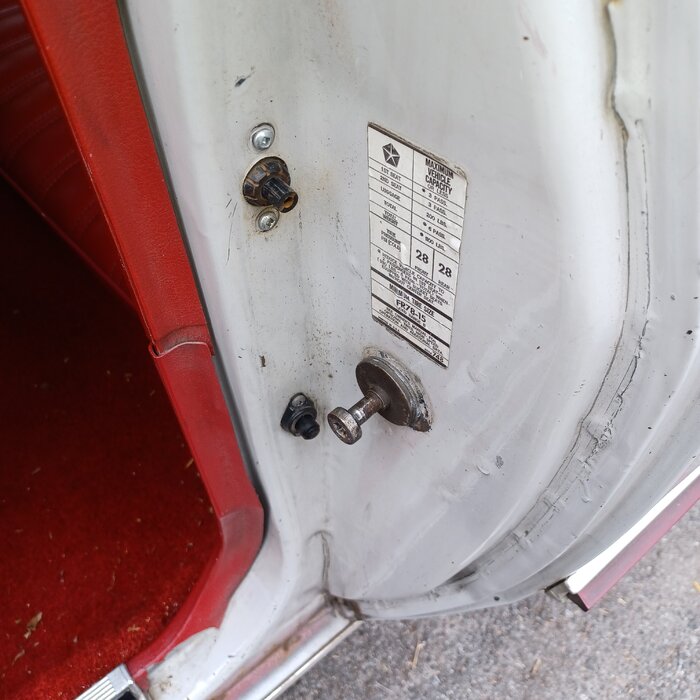

Maybe the latch is bad? When you say it doesn`t shut right do you mean it pops back when closing? Is the striker wore out? Are you aware that the striker can be adjusted.
1,848
1,048
Hinge pin is probably worn. Got a buddy with a lathe that turned me a new one when I had that issue.

How does it not shut right?
One of mine the hinge is shot and the door drops when you open it. You can then cause more problems if you try to adjust the hinge instead of fixing the actual problem.

I think the guy just slapped a replacement door hinge on it from another M body Mopar and didn't bother to either shim her right or just called it a day. The striker looks like crap and the window regulator isn't working right. I haven't taken the door panel off yet to check that I assume it's due to him slamming it. You may have seen the one that's on YouTube the white Caravell with the red top and the tall kid with that cowboy hat I think it was that's the Caravelle I have I can't explain why I got it except that I just like the boat tail coupes and I was up real late and wasn't thinking right.

No, this thing doesn't wiggle much at all. I'm just trying to figure out what I might be missing on this thing at one of my neighbors she used to work at a Body Shop tell me this well you gotta take the fenders and all off no I don't think so so we should do it different than at at Donald brown I did my charger doors and they were hanging down all I did with that was just replaced the pin but these look like they got new pins in them and also in the passenger side you just barely flick it and it shuts like it's brand new I think the kid just screwed up when he hung this door hinge. I'm thinking I may have to put some shims behind a lower hinge or something and figure this out they don't look like it has shims in there at all I could try taking the top ones out and seeing if that works but looks like I can go in defender well and get to all the bolts because I can just undo the plastic part of the inner Fender well and just fold it back and I can get in there with the believe it's a 9 /16 5/8bolt

Yes you can get in there from the wheel no need to remove the fender. There shouldn't be any shims, that's GM thinking. Maybe they bolted it together without trying to adjust anything so one of the hinges is binding. Or if they only replaced one hinge they might have adjusted the other one to compensate for worn pins and didn't adjust it back when they replaced the other one? Either way unless something is worn out it shouldn't be too hard to fix.
