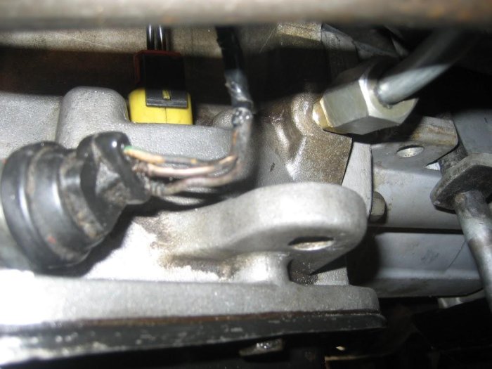

I'm looking for the either the wiring harness with the connectors or the connectors with short lengths of wire. Picture below for clarity. The 'reverse/neutral' connector is a 3 pin female and the 'lock-up' connector is also a 3 pin female. As far as I know neither connector is available as a spare part or as an aftermarket item. Appreciate any feedback or workarounds you may have.

The round neutral safety switch plug is the same as the old ones and is readily available. It looks like most of the transmission parts places sell the other one. Performance and cope come up when you google it.

Doh!!! Feel like such an idiot, I assumed the 'reverse / neutral' switch and connector on my '88 904 would be different from the '95 A518 I have. Never even thought to check!! Checked RockAuto and they do stock the switch as well as the connector - never thought to look for the connector on their site. Pity they don't stock the connector for the torque convertor lock-up.
80Mirada - I was aware of the bits that PATC carries. They have a three pin connector that will work with the existing 'torque convertor lock-up' electrical fitting in the A518. Apparently it isn't an exact fit but easily modified. Plus they carry speedometer gears one of which I will need due to the swap from 2.94 to 3.55 rear gear.

Is that a Weathertight style connector???
If so, you are actually in a pretty good shape because you can get these in the aftermarket in basicaly any counts of connector pins.
Just do a few online searches for what that connector style looks like, but basically it has a 'built-in' rubber insulating ring into the connector casing so that no moisture etc. impacts the connectors themselves.

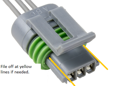

Finding nice automotive electrical connectors is always a challenge - unless you but one of those 'kits' via Eastwood or the Chinese knock offs via Amazon. Yes, the connector supplied by PATC (see URL below as well as picture), is a 'Weather-Tight' style connector. Along with a little dielectric grease it should work OK for the torque convertor lock-up connection.
Lucky you - your Mopar electronic ignition module is a collectors item as it is no longer available. :)
#79M, 518 / 46RH / 47RH Three Wire Pigtail Connector for Overdrive and Lock-up, NOT A DIRECT OEM FIT

Ohhh...hold that thought, I should have actually pointed to the connector I picked up for my intended use, which is an Allstar part => 6-Wire Weather Pack Connector Kit ALL76270
Now even better, here is a link to their 3-pin setup => 3-Wire Weather Pack Connector Kit ALL76267
Hey...$8.79 price beats PATC's $23, and I think the different here may be the round vs square pin. Round is what the Allstar stuff has.
