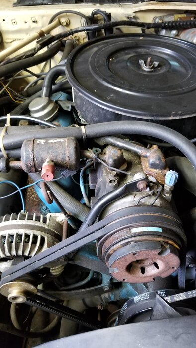

The problem is I have no idea what mods have been done to this car. The original owner (Im the 4th, 2nd and 3rd made no alterations) provided no work history with the car but there have been several aftermarket discoveries as I've toyed around with it. Any idea how I could tell?
7,323
2,971

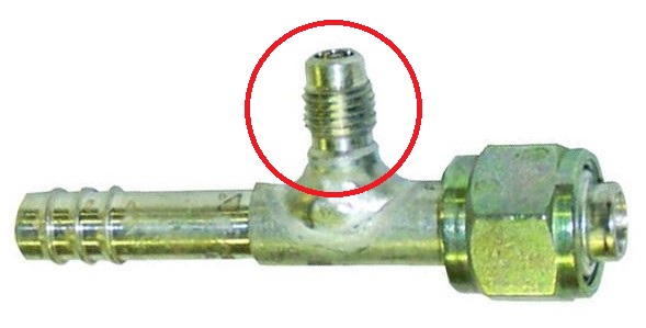

From what I can see, I'd say it's got R134a in it. Another way to tell is, R12 charge ports have external threads, R134a uses a quick connector type charging port (threads for cap are internal).

On Chrysler's, the R-12 service ports are identical in size (and shape) and looks like this (when cap is removed):

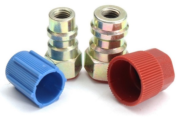

R-134a service ports are different sized and look like this (when cap is removed):
These adapters screw onto your existing R-12 service ports and use glue ,or something, so they can not be removed.
R-134a adapter size are made to keep someone from adding refrigerant into the wrong side. Red cap is high side and blue cap is low side
I can't tell by the pictures, but would guess your car has already been converted to R-134a.

I agree. That's still the stock hose and shouldn't have a fitting that big on it unless it was converted. Pop the caps off and see what's there.

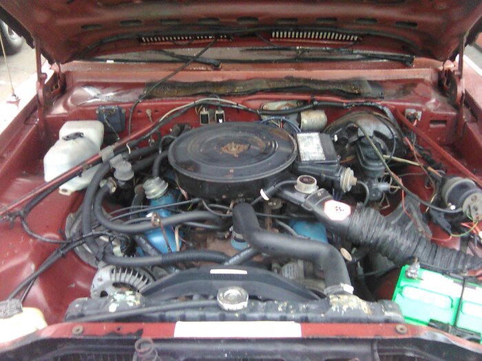

1,146
JBFury...
I'm thinking that you have an exceptionally clean engine bay.
Should you ever find yourself in NE Texas, please feel free to stop by and you can work your magic on my car's engine bay. I'll provide a shade umbrella and cool beverage of choice!

Haha, thanks. I feel the pics may be deceptive though. I'll take you up on it if I'm ever that way. Lol

Done with a power washer and a bottle of Purple Power about 2 weeks ago. Not hard to do, just make sure you hose the whole car down before and after so nothing happens to the paint
