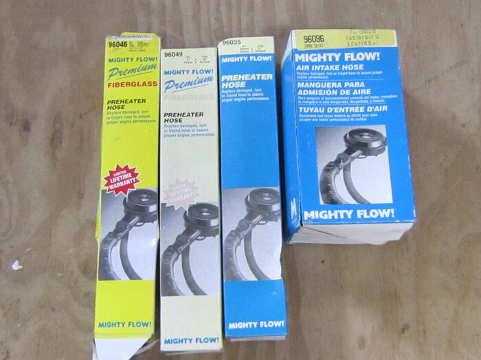

I searched closed ebay listings to find one with a picture of the box. I'm posting the images here in case someone in the future has the same question. I also found an active ebay listing with 7 in stock using the part number found in these pics. The Mighty Flow part number is 96068. This might be the Dorman number too if you can find ones-l1600 (19).jpgs-l1600 (21).jpg
