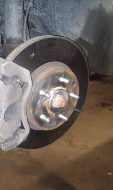

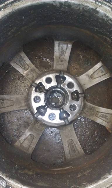

So, what's the deal with re-torquing anyway? Put aluminum against steel and what have you got? One simple word: corrosion. That corrosion acts like a sponge. You get the wheel torqued down to spec only to have it wobble loose a little while later, that's because the corrosion has absorbed your torque values and actually kept the lugs from tightening properly. Because the corrosion isn't a true mating surface, either, the wheel isn't seating flat on the facing of the rotor or drum, allowing your torque values to be all over the place.
I was doing a tire rotation on an '04 Jag the other day and decided to take these pics as a PSA.
The first two pics are of the corrosion:

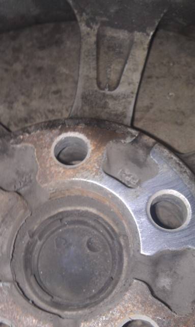

This pic is cleaning the corrosion off the wheel for comparison's sake:

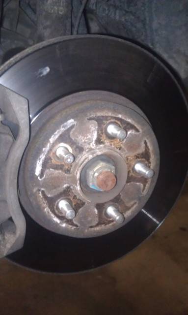

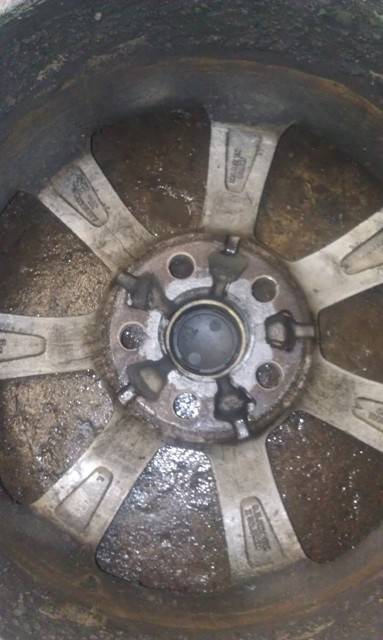

These are of the mating surfaces all cleaned up and ready to go.
If you've got drums the process is even easier. You can pop the drum off and you don't have to work around the lugs studs.
