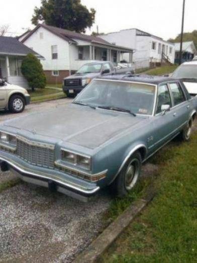

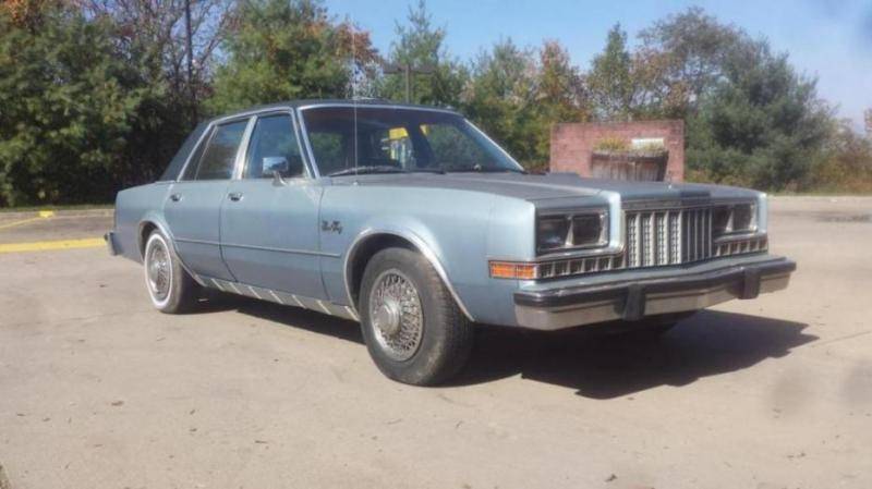

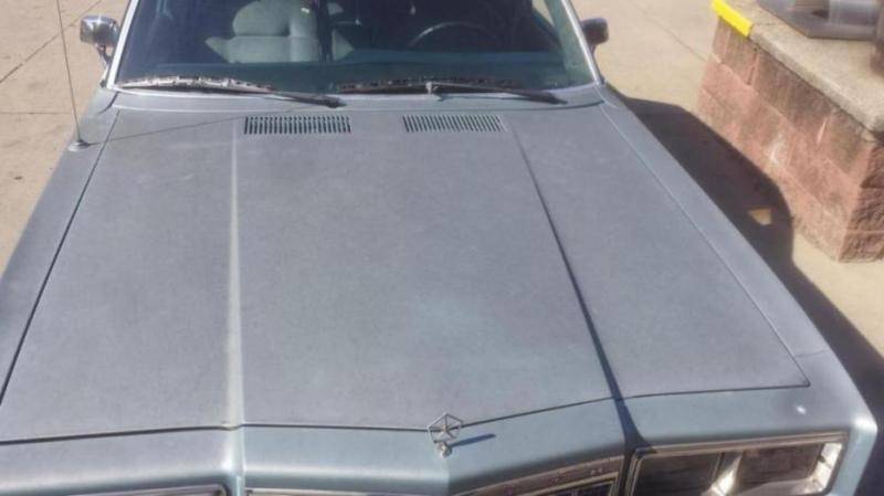

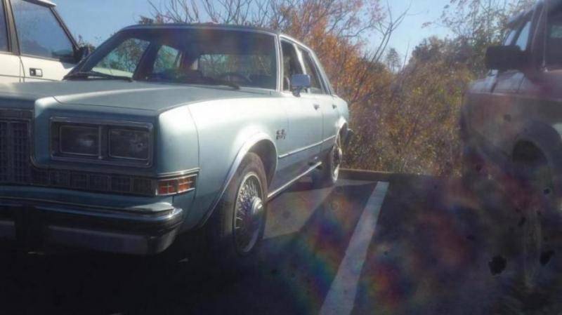

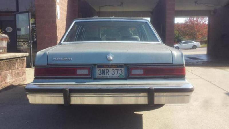

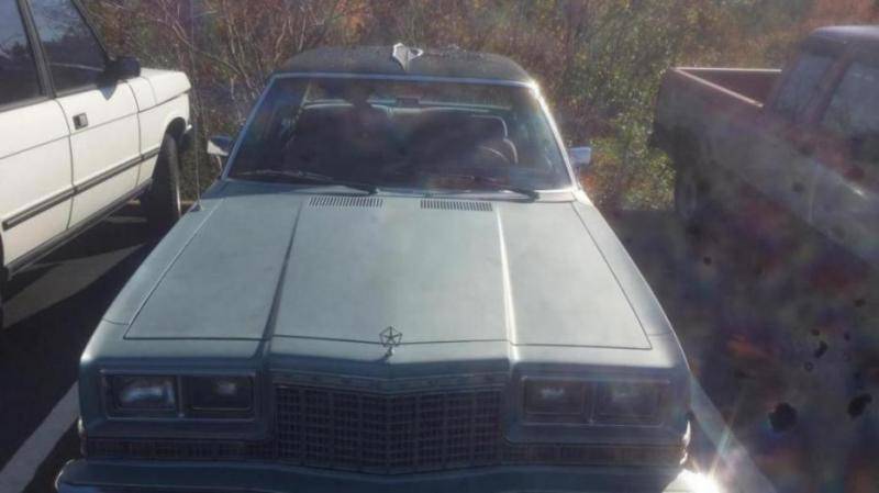

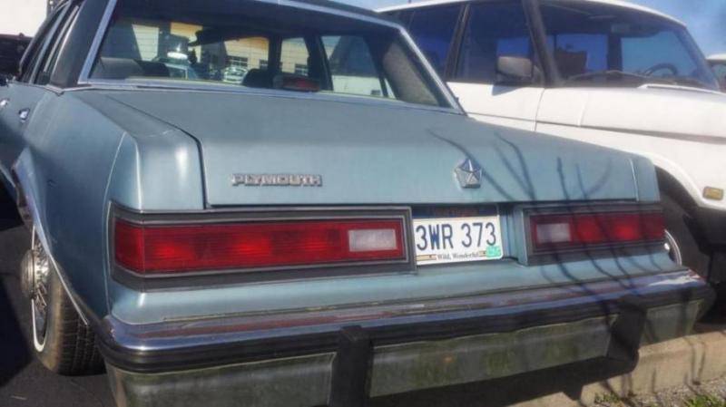

Greetings all from the mountain state of West Virginia! I recently came upon a post on the local Facebook yardsale feed for an 87 Gran Fury. So I went to look at it and after a little bit of back and fourth, decided to pick it up.
She's a 1987 Plymouth Gran Fury Salon 318 auto. Vinyl top is weather torn, interior plastics are brittle and paint is dead. The chrome is peeling, the lights leak, and the passenger rocker chrome is missing. No rust (extremely rare here) and only minor dings and scratches. Best of all, only 38k on the clock. Enjoy!

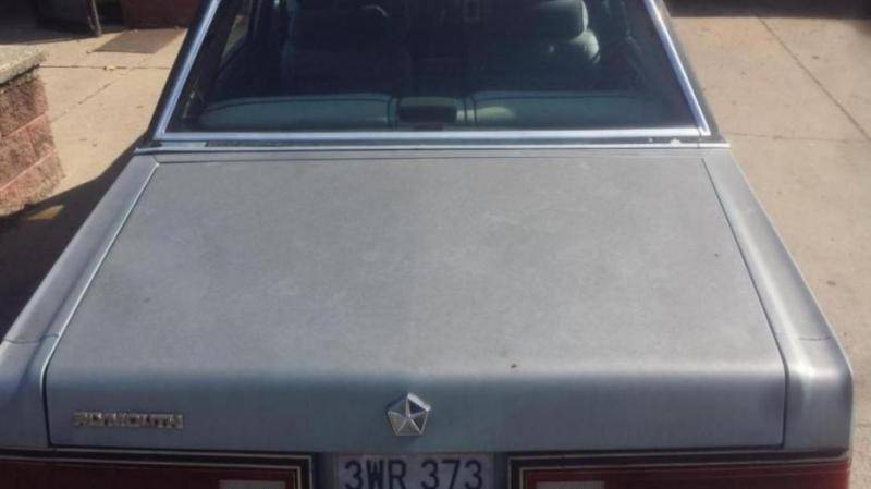

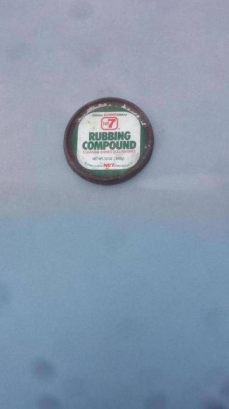

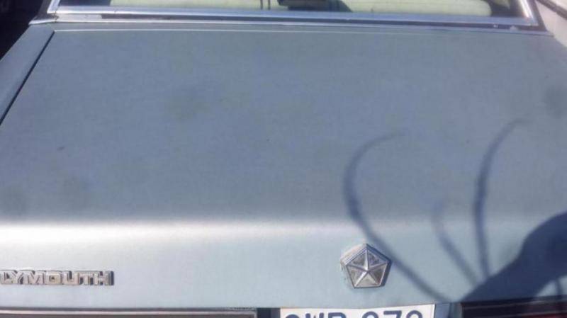

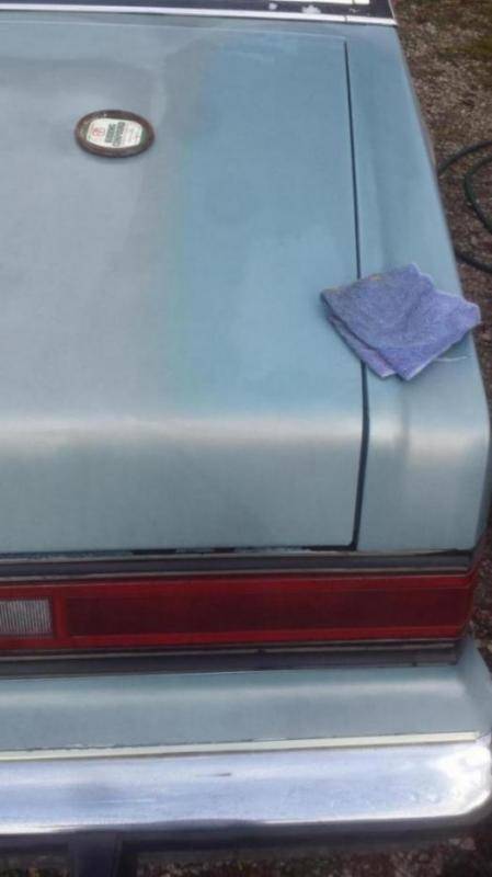

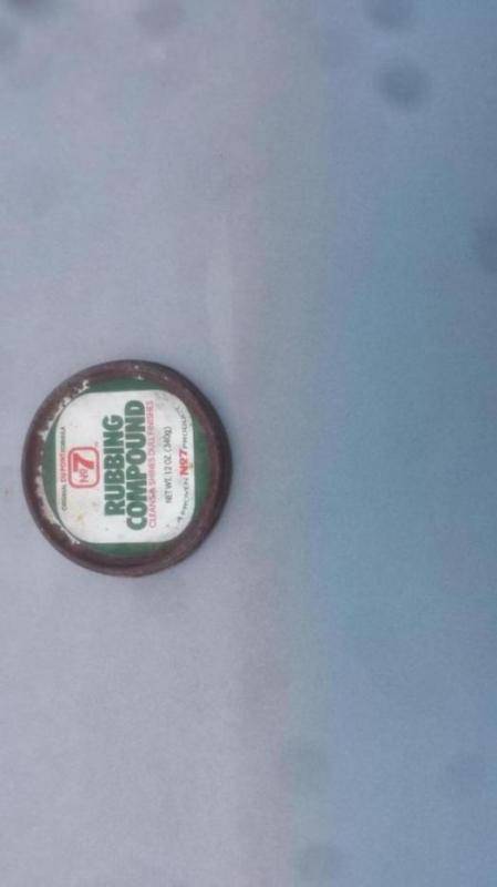

Also did some paint cleaning with some rubbing compound found in my dad's basement made a big difference!

Nice score, that color is sharp cleaned up
Its still really dull. You can tell its has had a Maaco or Earl Scheib paint job done to it. Single stage, no clear, non laquer job. covered in fish eyes and orange peel. it looks to be about 10-15 years old too considering it has lost its shine. Nice matte (or dare I say semi-gloss) look on the car. The sides below the door handles shined up OK but still not "shiny". maybe someday this spring ill do the top and get a respray that's quality. Like to have base/color/clear maybe in a metallic or pearlescent. That would be nice.

Single stage, no clear coat was the way it was done back then. I think the factory used urethane enamel, but the bodywork knowledgeable will correct me if I am wrong.
Fish eyes and orange peel are just signs of a rushed or poor quality job. Your car, your choice on repaint, but you may want to consider keeping the colour the same, just going with a basecoat/clear lacquer combination. Will save a lot of money on painting shut lines, and its a pretty nice colour to my eyes.

Factory should be single stage acrylic enamel. Lacquer can oxides very quickly, but you can use just about any clear over it. Many Japanese cars were acrylic urethane over lacquer up until 2000., makes for a quick paint job with good durability and shine.

The background in your picture reminds me of West Virginia... Lots of inclines..
Are you planning on keeping the same color family with your metallic or trying something completely different?

Same color family. I like the old gal in baby blue. Reminds me of the 90 plymouth voyager I grew up in. We had that thing for 15 years. The last few years of its life were spent as a parts car for my 90 lebaron but I digress.
I'm thinking either a pearl or metallic baby blue and keep the top as a slightly darker blie to match the interior or go all out and paint it plum crazy and remove the vinyl top and redo the inside in white leather/vinyl.
I'm leaning more towards stock with a light metallic just to class it up a bit.
