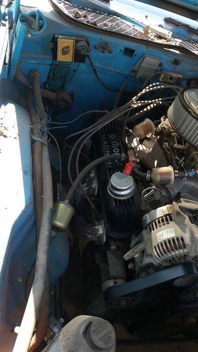

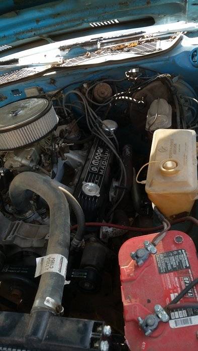

Unrelated. I took some pictures of a 360 Magnum 4-speed that was installed into a ’73 Road Runner. The widow is trying to sell the car after he had a sudden heart attack. He just got the car together and drove car once, the night before he died.
She did comment that he was happy because car would get sideways without much effort.
Pictures taken on August 19.
