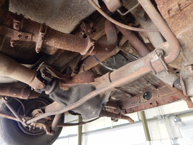

I have a couple B body cop cars I can get a pic later tonight

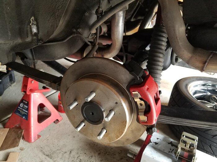

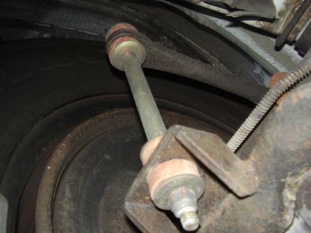

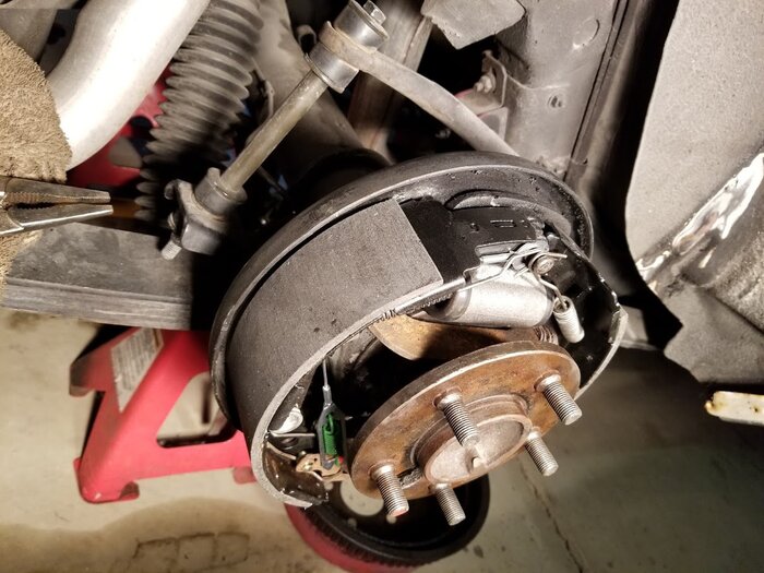

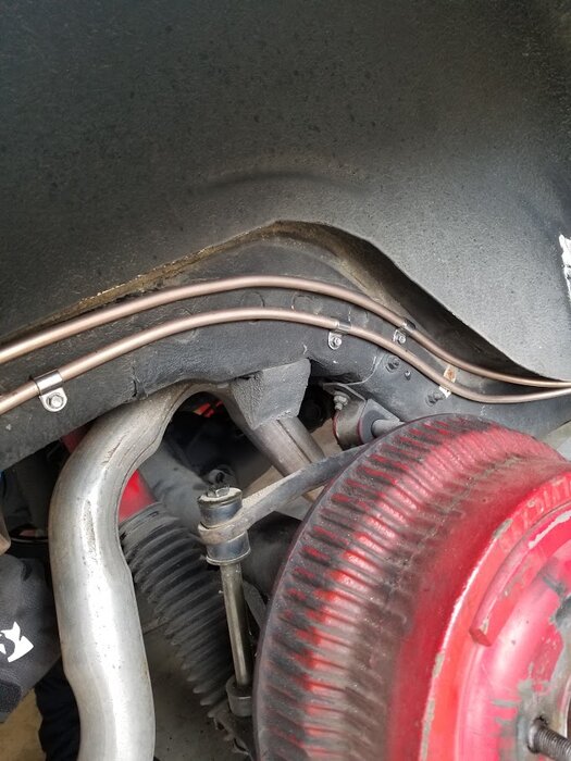

Curious, did you have to get some axle plates as well, for the links? Here's a pic of my M body Police car. The bar mounts over the diff not under like B body but just curious about additional parts you needed to get to mount the bar.
1,806
1,014
Here is a bunch of random photos taken over the years. The bar attaches to the frame rails, then swings down to attach to the axle via the end links.
