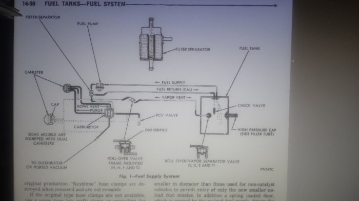

Looking for a picture of the frame mounted Fuel Roll Over Valve? Mounts on the inter rocker on the passenger side. I know what the part looks like, I just need to see how the fuel lines run... And I assume its on the Main gas fuel line. (Not the vapor return line) Took this apart a year ago, and thought I took a picture. An can seem to find it.

Rollover valve goes in the vent line. Maybe a pic from the service manual will help a little? My car has the valve in the top of the tank. I'll try to see if I can get some decent pics of the e‐brake today, unless someone beats me to it.
