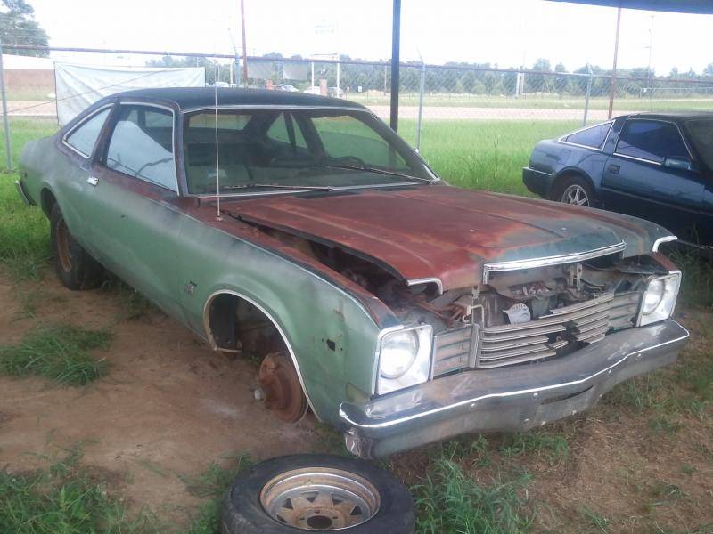

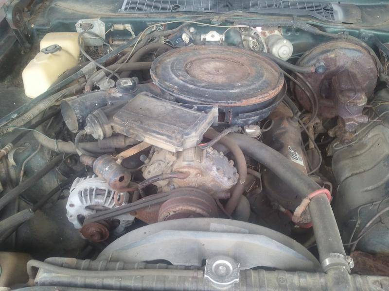

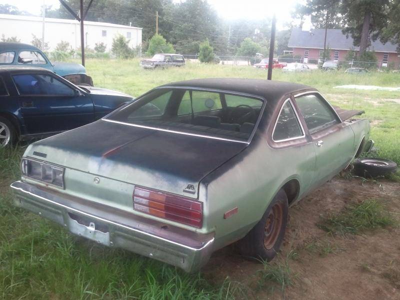

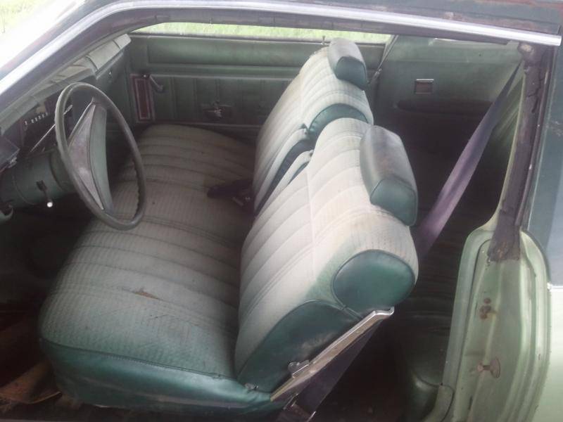

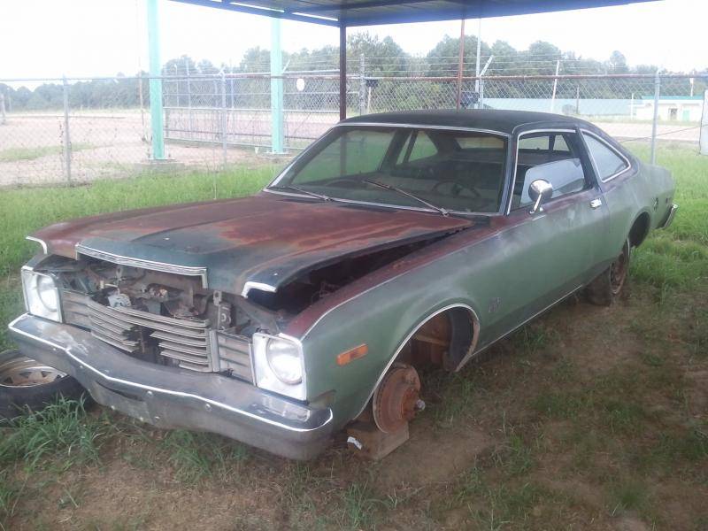

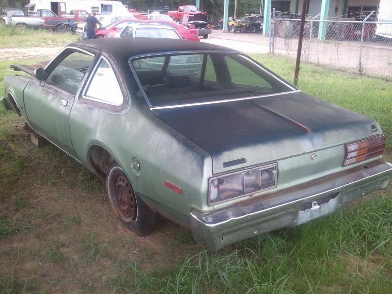

Here are pictures of 1978 Dodge Aspen we acquired a couple of weeks ago. After giving some thought about what to do with the car I finally elected to build the car into a NHRA/IHRA Stock Eliminator race car. Originally a 318 2bbl car we have decided to run it with the 318 engine with factory horsepower rating of 155 and factored to 230hp @ 13.73 pounds per rated horsepower which puts the car in L/SA 3275 lbs with the driver in it. We are allowed to add or remove weight to move up or down a class and may if we see there is a need to. The NHRA national record is now set at a minimum 0f 12.20 second in 1/4 mile and 8.01 seconds in the 1/8 mile as no one has tried to set a record in either distance in several years. The NHRA class index (which is used as a performance basis in qualifying, etc.) is a 12.70 in NHRA. The IHRA 1/4 national record for L/SA is 12.21 @ 106.40 by Danny Waters, Jr. in a 283 powered 1966 Chevrolet Chevy II.
