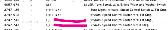

This is from my '79 parts manual:
Note: I have seen colored stalks not available over the parts counter. I guess it is easier to carry 1 part (in black) than to carry multiple parts that may or might not sell, maybe. The later years do come colored over the Chrysler parts counter.
I have NOT done a comparison between ('80 and up FMJ) Tilt and non-Tilt switches - but "suspect" the only difference is wire length.
