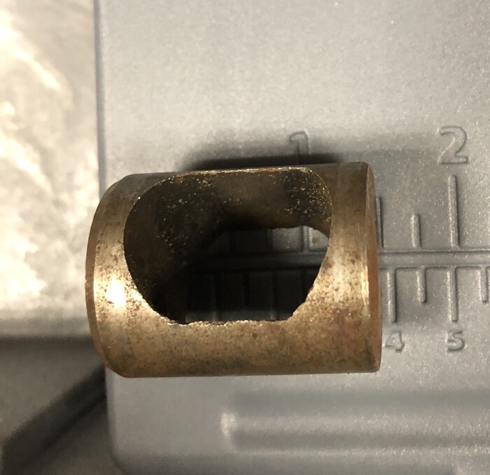

Mar 4, 2021 #1 Davesmopar Well-Known Member Joined Sep 1, 2019 Messages 252 Reaction score 31 Location Hendersonville, Tn What is the proper fix for too much end play?? 8.75/spool.... both sides..
Mar 5, 2021 #2 MiradaMegacab Well-Known Member Joined Feb 27, 2011 Messages 1,847 Reaction score 754 Location Long Island NY Hmm, do the axles require thrust buttons? Did you install a thrust block? You might have to swap out the axle bearings to the Green bearings as there’s no end play adjuster needed. See post #2 8 3/4 spool with stock axel bearings.. Last edited: Mar 5, 2021
Mar 6, 2021 #3 Davesmopar Well-Known Member Joined Sep 1, 2019 Messages 252 Reaction score 31 Location Hendersonville, Tn Ty and good read.....
Mar 6, 2021 #4 MiradaMegacab Well-Known Member Joined Feb 27, 2011 Messages 1,847 Reaction score 754 Location Long Island NY I have a thrust block available if you need one. You can make one, they are 1.5” long.
Mar 14, 2021 #5 Davesmopar Well-Known Member Joined Sep 1, 2019 Messages 252 Reaction score 31 Location Hendersonville, Tn I made one and end play is set now Thanks for your help
