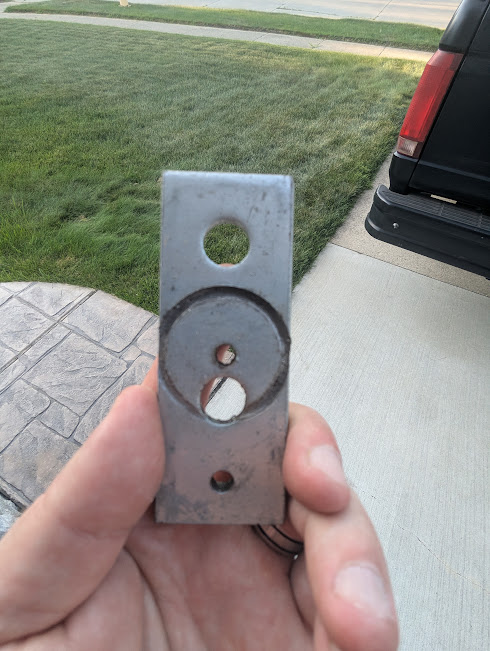

If you plan on keeping the original ISO-clamp shock plates (with the older B-body differential), you will need to make the centering hole wider on the differential perches to 1-9/16" (not a fun process, but doable).
No problem at all. Cut a piece of flatstock and bolt it to the underside of the perch through the u-bolt holes. Center punch it and use that to guide the arbor.
