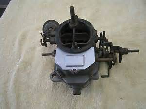

This is my favorite Carter came on about75-78 318 pickups and vans. Easy to work on kits avail. They had adjustable metering rods.
