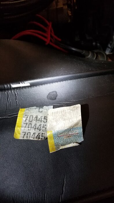

If I can remember when I get home I'll look. I've got a big block with a passenger side outlet. Tag might still be on the hose.

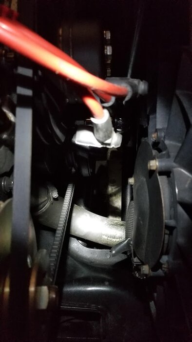

That's the hose I probably used, or maybe not. While looking at it, remembered I had to trim an inch or so off the pump housing end, otherwise it came down too low and was against the k-frame. That made the hose angle different, so it hit the fan shroud, which resulted in needing to notch the shroud for clearance. One thing leads to another.............lol.
