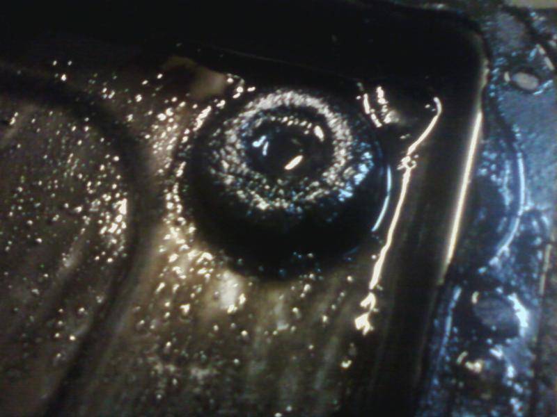

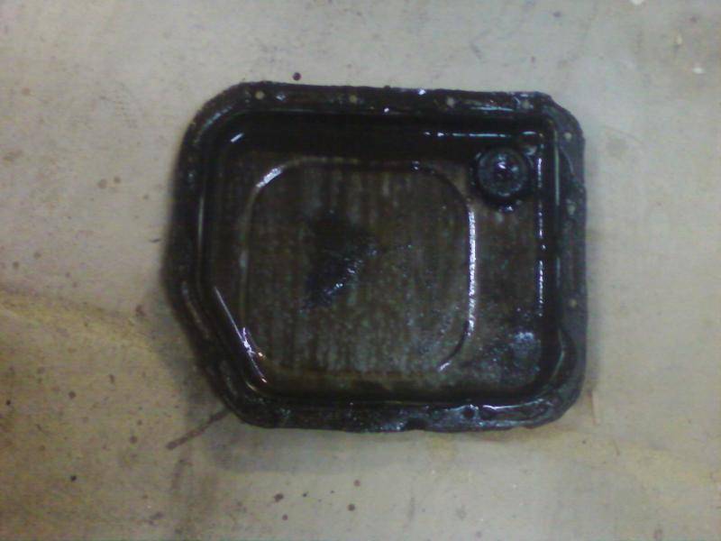

Pics of my black pan of death from the trans I pulled out of my 81 Mirada. PO connected the cooler lines together and let it do its own Chernobyl style melt down The color and smell of the fluid along with the shuddering on acceleration and slippage between gear changes and leaks. was more than enough warning to change.
and no that isnt a fur coat the pan magnet is wearing,its the metal particles from the internals as it was self destructing

Looks like an A500 pan, epsecially with the magnet being there. Was the pickup lowered to accomodate the deeper sump?

No. Its a ruined stock A-904, the replacement used 904 has the magnet also. Minus the blackness and metal shavings

I'm pretty sure the A500 and A904 pans interchange, as do the A727 and A518 pans. They are the same beloved transmssions with an overdrive stuck onto the end, with electrical lines to activate the overdrive and torque converter lock up.
