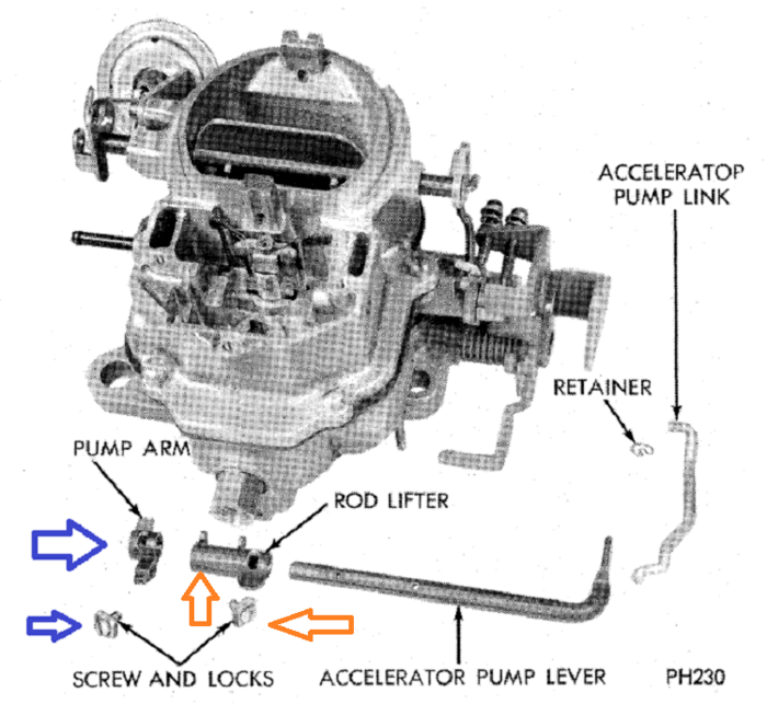

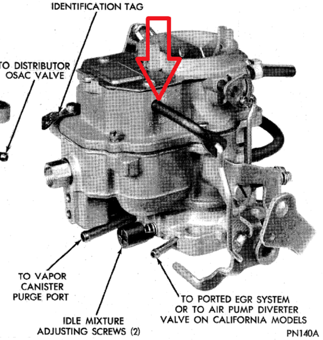

The rod marked with red arrow is your accelerator pump arm. When you move the throttle open, you should also see that arm move as well (in relationship to throttle).
What I suspect might have happened is a screw has loosened. Inside the top cover, the arm has two different adjustments. One is for accelerator pump and other is for power valve. If either screw has loosened or is misadjusted, it will cause a bog.
Blue is the accelerator pump and orange is for the power jet/metering rods.
The levers inside (pump arm and rod lifter) that screw onto the arm can be made from plastic (most are) and sometimes can have loose screws.
There is an official procedure to adjust both levers – but it is a pain sense there is not a lot of room to work in that cavity.

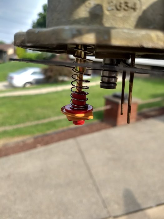

The color of the one we are using now is yellow cup part, red core...came in the kit....and it is very deformed.

The son put it all back together using a new pump from an old kit we had on hand....green in color.....
He says it still seemed to hesitate some and then he tweaked the setting and now it's ok.
1,492
Someone got in a hurry when it was assembled.
What lube to use doesn’t matter much. Gas or engine oil will work. Never tried Vaseline (which is what I use for transmission lip seals and check balls) for this - but no reason it won’t work. The “cup” needs a liquid presence for it to get primed with gas. Once that happens, all is good.
Without some liquid, it will take many pumps before accelerator pump gets primed.
Also, a bit of liquid/lube helps to prevent the problem you have with current accelerator pump piston cup.
If I was there, and if you removed the carburetor top only, I would have pulled the engine dipstick and gotten a finger tip worth of engine oil to wipe on the cup.
Glad problem is fixed. It wasn’t exactly what I thought was wrong – but close.
