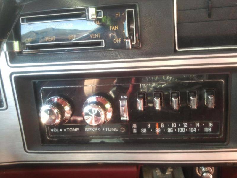

I had a good laugh today my wife asked me today are you gonna put a cd player in that old car. I said nope all we have is AM/FM push button baby and it will stay that way Lol. I had it rocking on one speaker.:icon_super:

I do a lot of one speaker rocking myself in the Volare.
I love it....still hear the tunes AND the engine!!
