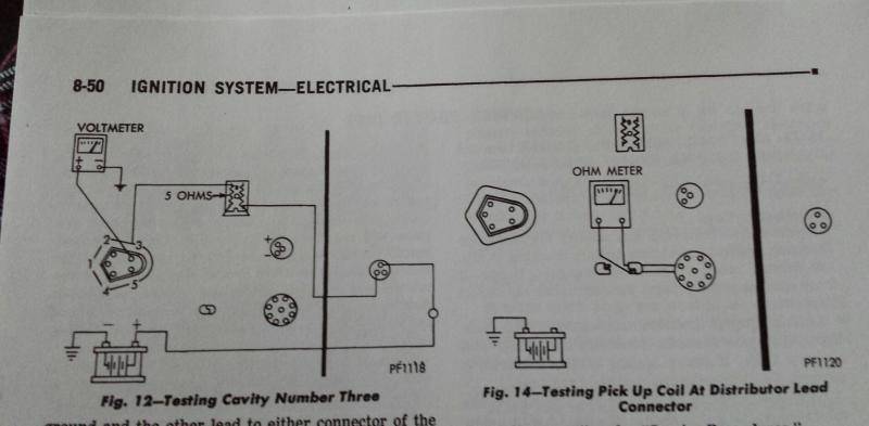

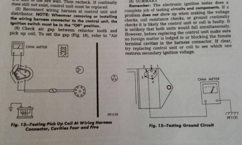

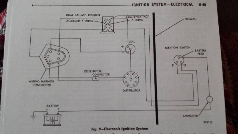

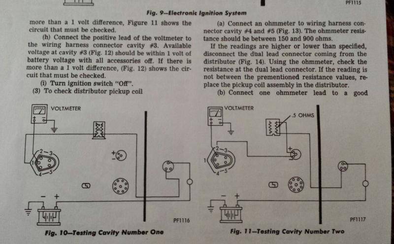

Can someone tell me if you can test an ECU box?
greymouser7
Mar 11, 2011
1,079
90
31547 off of I-95 near I-10
Can you run voltage to one connector and test the others? Input voltage -> output voltage or 0 volts (insulated)
Or check grounds/measure resistance?
to see if the box is functioning properly?
10,745
1,205
Here ya go....

I think I bought mine for $20.00. I need to figure out the wiring and use an old piece of wiring harness. I never have needed one, but the Aspen is puking out resin so it is on the list.
