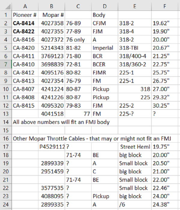

1,492
I had compiled this list (top part) from a Pioneer (brand name) catalog and lower part from internet sources.
I’ve not made any measurements to verify the “length data” – but don’t have any reason to doubt the data to not be correct.
Both segments are sorted by length (column "F")
1,492
I have not owned a /6 before (worked on plenty, though) – nor have I personally measured any throttle cables for length.
All I did was make note of what I found on the internet and in a Pioneer throttle cable catalog - for my own reference (Big block, 6-pack and for fuel injection possibilities).
I do know that a /6 1-bbl and 2-bbl cables are different length – so a cable will be needed in a 2-bbl (Super 6) changeover (is not even close to being long enough to fit).
I’ve heard stories of other forum members using a /6 1-bbl throttle cable when replacing with a V8 engine changeover – without troubles – but I suspect a /6 2-bbl cable might be too long to work with a V8.

Its a good thing that this info is available and now comes to the internet. Thanks BUDW
